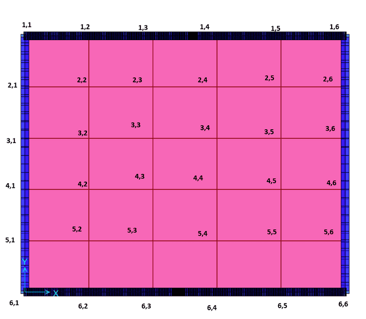

Here is how I have discretized the slab:
Finite difference grid over a rectangular concrete slab, with a 5 by 5 array of cells labelled by node indices from 1,1 to 6,6 along the edges, shaded pink with blue border strips.
I am using the fourth order finite difference which is:
Fourth-order finite difference stencil written as a fraction: numerator (1·v(i-2) − 4·v(i-1) + 6·v(i) − 4·v(i+1) + 1·v(i+2)) over h to the power 4.
To start with I would ask are there any boundary conditions in this example? It does not look like there are. The displacement, rotation or moments are all unknown over the entire slab.
The slab is not supported on its corner points, with infinite pressure, the edges of the slab, rest on the building framework, modelled with vertical forces.

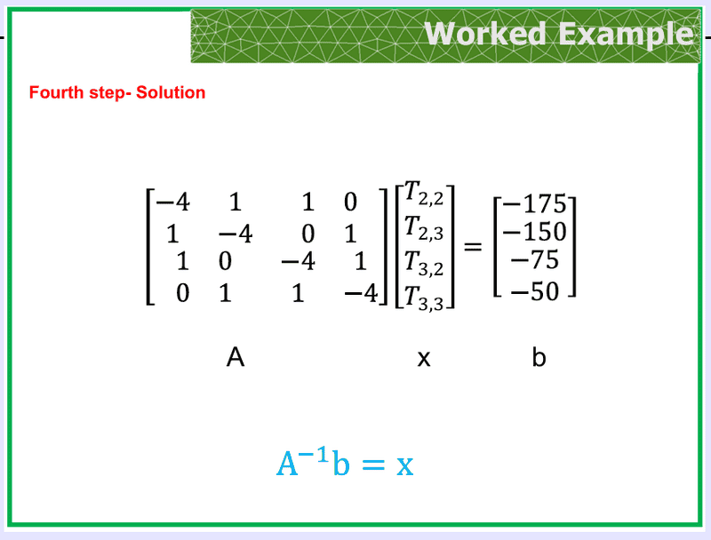

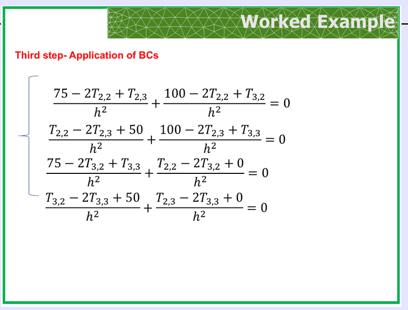

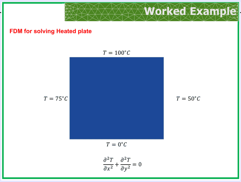

The example if for a heated plate:
Worked example slide titled FDM for solving Heated plate: a square plate with boundary temperatures T = 100°C on top, T = 75°C on the left, T = 50°C on the right and T = 0°C on the bottom, with Laplace equation d²T/dx² + d²T/dy² = 0 below.
Slide titled Worked Example showing a 4x4 grid of nodes for a 2D heat conduction discretization, with interior nodes T2,2, T2,3, T3,2 and T3,3 boxed in red; boundary values T1,: = 100, T:,1 = 75, T:,4 = 50, T4,: = 0, and the Laplace equation d2T/dx2 + d2T/dy2 = 0.
Slide titled Worked Example reading Second step- Resolution of the PDE for the interior points, showing four finite-difference equations in T with h squared denominators, each set equal to zero.
Slide titled Worked Example, subheading Third step- Application of BCs, showing four finite-difference equations with h squared denominators, each summing to zero and containing terms T2,2, T2,3, T3,2 and T3,3 with constants 75, 100 and 50.
Worked example slide, fourth step solution: matrix equation A x = b, where A is a 4x4 matrix with diagonal entries -4 and off-diagonal 1s and 0s, x holds T(2,2), T(2,3), T(3,2), T(3,3), and b is (-175, -150, -75, -50); below it, A^-1 b = x.
I was thinking I could adapt this for a concrete slab and use the forth order equation.

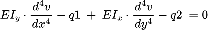

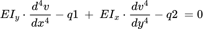

This is the first go at a 2D problem. However, I have done many 1D problems involving beams. For this reason, I am wondering about the loading on the slab. In the model I have applied an area load of 5 kN/m^2. How would I apply this using the finite difference method for the slab for this 2D problem? Considering q is not 5 kN/m, but 5 kN/m^2?
Tygra, in your original post you wrote the equations for the deflection of a beam (except the dx in the denominator should be to the fourth power not the second). The resulting units for q come out to force per unit length. Although the same symbol q is used to represent a distributed load in plate theory, the units for this distributed load are force per unit area. If you are given a load on the slab to be 5kN/m^2, that is an appropriate set of units.
Sorry, that h^2 was a typo.
What I mean is, T1m0:
If q is the force per unit length q can't be 5 kN/m2; q must be 5 kN/m^2 multiplied by the side length of the slab. The slab is 4m in the x direction and 5m in the y direction. So, in the x direction q = 5 kN/m^2*4m = 20 kN/m and in the y direction q =5 kN/m^2*5m= 25 kN/m.
Thus, would I be correct to set up the equations as?
Equation: EI_y · d^4v/dx^4 − qx + EI_x · d^4v/dy^4 − qy = 0
  • Equation: EI_y · d^4v/dx^4 − q1 + EI_x · dv^4/dy^4 − q2 = 0
  • Equation: EI_y · d^4v/dx^4 − q1 + EI_x · d^4v/dy^4 − q2 = 0
Tygra, the equation that you came up with is an oversimplification of the mechanical behavior of the slab (plate). The correct model for the slab is the equation for plate bending which has a mixed derivative in the differential equation for the deflection. The distributed load q in plate theory has dimensions of force per unit area because it acts over a two dimensional surface. The distributed load q in beam theory acts of a one dimensional object has has dimensions of force per unit length.

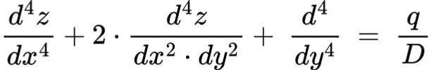

T1m0, I went to the university library and got a book called "Numerical Methods for Engineers". In this book it gave an example to solve for the deflection of a plate.
The starting equation is:
Equation: d^4z/dx^4 + 2 · d^4z/(dx^2 dy^2) + d^4/dy^4 = q/D, the biharmonic plate equation with fourth-order partial derivatives of z.
This must be the mixed derivative you were talking about?

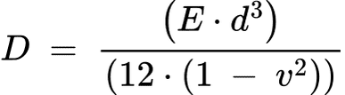

where D =
Equation D = (E · d^3) / (12 · (1 − v^2)), a flexural rigidity formula for a plate with E, d and v in the numerator and denominator as shown.

I am now getting the correct values for the deflection of the slab in my particular example!
Many thanks for your help!
