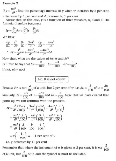

From examples, to solve the problem I don't need to be adding quadrature. Here is an example:
So it is a small deviation (calculus) problem, not an "error" (physics) problem per se.
Yes, correct.
