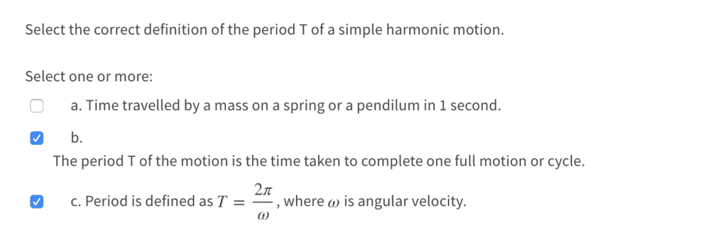

Ok so here are a few multiple choice questions that I have been given to me and these are what my selected options turned out to be

Do they seem right?
I am rather confused on the wording of the first question?
Is it asking to state the conditions of SHM for it be in SHM?
I know that from the definition in my head SHM is a type of periodic motion or oscillation motion where the restoring force is directly proportional to the displacement and acts in the direction opposite to that of displacement
I know it must be option C as that matches in with the above definition I had given. Cannot be option B as it simply just says motion on a pendulum or spring but does not describe any features of SHM. But option A is describing Hooke's law and says nothing about the displacement or how acceleration is directly proportional to its displacement from equilibrium position?
Any help would be appreciated! Thanks
Q1. I'd agree with you that( a) is almost the same as (c), but (c) is a bit more general, so better.
Q2. Again, I'd vote (c) as best answer. I don't like (b) because Θ is undefined and I think angular velocity needs to be about some point/axis , but (b) might be liked by people here because it is mathematical rather than words. I'll wait to see what they come up with.
Q3. correct, (b).
Q4. This one I find most difficult. My first reaction was to prefer (b) as the general definition of period, rather than (c) which seems to me to be a mathematical consequence of the definition of SHM.
On further reflection (& re-reading the question) (c), being a consequence of SHM is actually an advantage, when the question asks for a definition specifically of period for SHM. So I'll go for (c) despite my loathing of math's taking ownership of physics!

Ok thanks this has definitely cleared up a bit of misunderstanding that I had :) This was helpful
