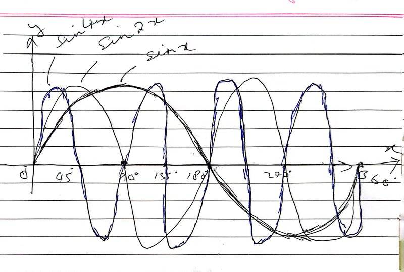

I have tried to plot the 3 graphs of ##y=sin{x}## in bold black, ## y= sin{2x}## in normal black and ##y=sin{4x}## in bold blue as shown below.
It seems that the combination of these 3 graphs will repeat every 360° or 2π radians. We can't say the combination will repeat every 180° or π radians since the graph of ##y = sin x## is inverted after 180° even though the patterns of ## y= sin{2x}## and ## y= sin{4x}## graphs are repeating every 180°. The superposition of multiple graphs depends entirely on the pattern of individual graphs; so, if patterns of graphs do not change then the superposition of these graphs will not change.
From above explanation, we can say that motion is periodic with a time period equal to the time period of ##y= sin {\omega t}## which is ##T= \dfrac {2\pi}{\omega}##.
Although a plot generated by computer (there are many free online plotting apps) would have been better, I think you have grasped the idea and expressed it in your own words which is good.
You have found that the period of this function is ##T=2\pi/\omega##. Now you have to show that the function is not harmonic. Others have suggested to show that the equation ##\dfrac{d^2x}{dt^2}=-\Omega^2 x## where ##\Omega## is constant does not hold for all values of ##t##. That's a good way to do it. However you might also consider how many harmonic functions there are that have the same period ##T=2\pi/\omega## (or frequency ##\omega##), make a list with their mathematical expressions and see if ##x## is on the list. If it's not, then ##x## is not harmonic.
