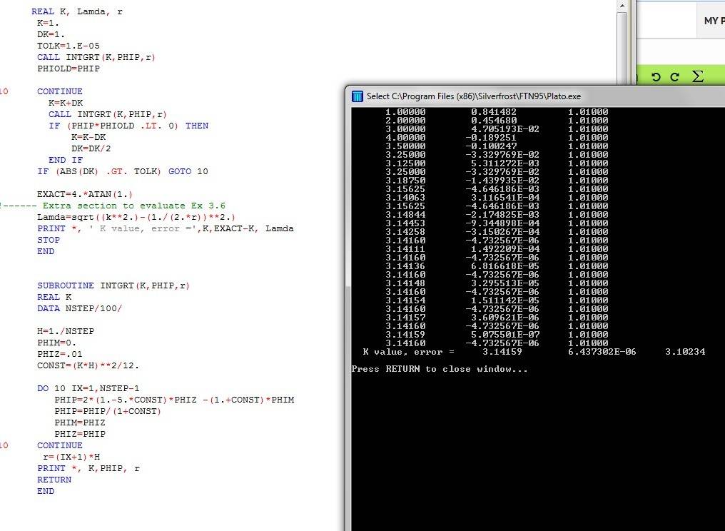

Hi, still hoping for some help with this, here's what I've done since the above.
Without that much confidence, I resorted to arithmetic and substituted $$\lambda=k^2 + \frac{1}{2r}^2$$
Then the given program already calculates my 'new' eigenvalue - $$\lambda$$ and I can easily substitute back to find k - a trivial change to the program. (While that sounds sensible, I can't shake the feeling I am missing something critical...).
Anyway, I also need to know the value of r for that, so I adapted their subroutine to return r as well.
But instead of getting the expected value for k (k BTW is just the wave number) which should be 2.404826 (solution to problem according to the text), I get k just smaller than pi (pi is the eigenvalue their original program returns, which is correct - $$k_{n}=v\pi$$)...
So to try and figure this out, I calculated manually what r should have been, and it should have been 0.2473. But I have no idea why my r (1.01) is wrong? or even if I am on the right track. My program and output is attached, be really grateful to get this finished, it is chapters of the text behind where I am busy now ...
