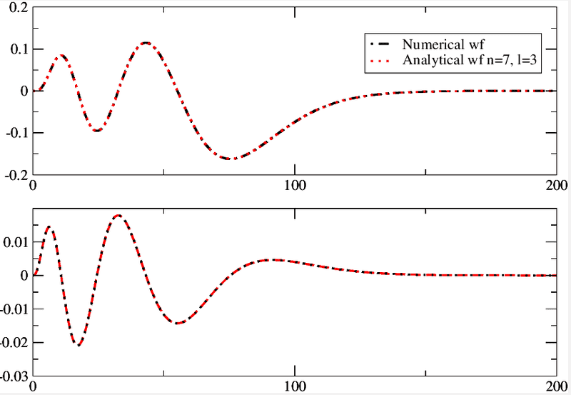

This is for example a result I've obtained previous to changing the grid (that is, with a uniform grid using Numerov method):
Two stacked line plots of wavefunction against x from 0 to 200: a dash-dot black numerical curve and a dotted red analytical curve, nearly overlapping, for n=7, l=3; the top panel spans about -0.2 to 0.2 and the bottom about -0.03 to 0.02.
Upwards are the numerical and analytical wavefunction (the program calculates the analytical wf by means of Laguerre polynomials). And downwards the derivatives. The program propagates from the outward to the inward region, and from the inward to the outward, and then matches both solutions, normalize, etc. I'm using the discontinuity at the matching point as a convergence criteria.
As you may see I have an excellent agreement if I use a proper number of points in the grid mesh to propagate the numerical solution.

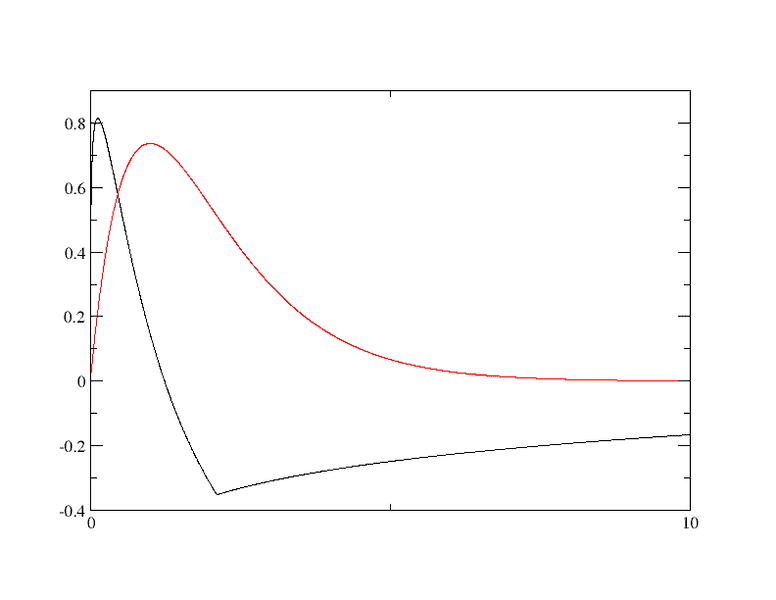

Now, when I've tried to implement the exponential grid this is what I obtain (this is for the ground state):
Plot of two curves over x from 0 to 10: a red curve rising from 0 to a peak near 0.73 around x≈1.5, then decaying to 0; a black curve spiking to about 0.8 near x=0, then dropping to a minimum near -0.35 around x≈2.5 and slowly rising toward -0.17 at x=10.
It looks awful, but the exterior region is actually not that bad. The thing is that when the program matches both solutions (inward and outward) it uses the value of the function propagating from the inward to the outward region at the matching point, and at that point the outward solution is already negative, so it looks like the matching procedure is inverting the wave function with respect to the x axis. What the wavefunction looks like is like if it were being compressed in the interior region, where there are a bigger number of points (the discrete grid is more dense in that region).

Well, I personally think that the issue is due to the discretization, basically I wanted to know if someone have worked with variable grids with this kind of multistep methods, and what would be expected to see by the trained eye. Is there anyway to save this problem or am I condemned with it? perhaps I reached as far as it can be taken, but I'm just not sure. I'm actually not sure about my hypothesis of this behaviour being given by the discretization it self, and if it is a reasonable thing trying to modify Numerovs method using the chain rule. I actually am not sure about the whole thing, but it worked pretty well on the uniform grid. I have checked many things in the program. I would like to know if this kind of problem is to be spected when changing the grid, I am no expert in numerical analysis.
