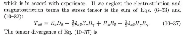

Let me say about a tiny findings. My old textbook Panofsky-Phylips second edition https://www.amazon.co.jp/-/en/Wolfgang-K-H-Panofsky/dp/0486439240 eq.(10-37) states that
The suffix order is different from your quote so its antisymmetric part has a different sign. So there seems to exist two ways of the definition at least.
Let us think only electro not magnetic part for simplicity. The medium body has anisotropic dielectric coefficient s ##\epsilon_1 > \epsilon_2 > \epsilon_3##.
$$T_{12}=\epsilon_2 E_1E_2=[\frac{\epsilon_1+\epsilon_2}{2} - \frac{\epsilon_1-\epsilon_2}{2}]E_1E_2$$
$$T_{21}=\epsilon_1 E_1E_2=[\frac{\epsilon_1+\epsilon_2}{2} + \frac{\epsilon_1-\epsilon_2}{2}]E_1E_2$$
etc. They are not the same and have symmetric and antisymmetric parts. I imagine antisymmetric part generates torque to media body so that the largest # \epsilon_1## has same direction with applied E so that free energy of the system be minimum. I would be glad if corrected.
The paper in arxiv you mentioned that your problem may concern the long history controverse. It may have something of your interest.

Coulomb force between the charges is a body force. Same situation is treated by Maxwell stress tensor in space. They are equivalent in effect. We can choose body force or tensor, but not both body force and tensor at a time. In our case "any forces which can be expressed by tensor form should not be counted in a body force" seems to be an appropriate approach. Otherwise the distinction of stress tensor and volume force would become meaningless.
anuttarasammyak said:
Say ##T_1## comes from EM, where does ##T##, which you say symmetric, come from ? I am not a specialist of materials at all so take it a question from beginners please.
a. ##T + T_1## is symmetric
b. ##T## is symmetric
c. ##T_1## is not symmetric
We agree with a. I am not sure such division b and c could take place.
Microscopically speaking the distinction doesnt exist.
##T## is supposed to account for contact forces. So forces between particles that are touching each other. On the micro scale, atoms and molecules never touch each other, the interaction they have is long range (i.e, body force). And these body forces are essentially electromagnetic, whether quantum or classical.
However, in the macro scale, the molecular and atomic distance where adjacent molecules interact with each other is regarded as negligible, so they are very much touching one another. So the electromagnetic force which is on the micro scale is long range, gets replaced by part long range part short range. This is a mere mathematical distinction to approximate the phenomena.
Specifically, ##T_1## represents what we would consider the force due to classical electromagnetic effects, you can understand it macroscopically as long range. However, once the (macroscopic) particles get closer and closer, the distinction becomes muddy, and you may have to account for surface effects, such as forces caused by surface charges.
##T## will represent anything else. Forces of quantum nature, friction, pressure. Anything that cannot be described by maxwell equations, but can via other types of phenomena. It is normally specified via some experimental relation, such as newton's law of viscosity, hooke's law, etc.
In a nutshell, the distinction is mathematicsl, not necessarily physical. It gets even worse if you start accounting for the EM fields themselves to support "pressure", then the charged particles "stresses" the field which then carries this stress at the speed of light to other charged particles, like a rope connecting two bodies.
Thank you so much for very kind explanation.
b. T is symmetric
c. T1 is not symmetric
I still do not find the evidence of this division.
The microscopic view denies the division to symmetric and non-symmetric tensors.
###T##is going to be symmetric per the first derivation. It is not necessarily symmetric per the second derivation.
The character of ##T_1## here doesnt matter. The only thing it does is, in the second derivation, making ##T## asymmetric if it is asymmetric. The results are conflicting because of this.
We know the whole tensor is symmetric. In mathematics no symmetric tensor is expressed as sum of symmetric tensor and non symmetric tensor. We can conclude that such division cannot take place.
Klaus3 said:
Klaus3 said:
assuming k=0
∫TndA+∫div(T1)dV=∫dpdtdV.
You express one of stress tensor in surface integral and the other in volume integral.
Then in angular momentum calculation you make the two in volume integral and find T , originally in surface integral, symmetric.
Further if we make the two in surface integral we will confirm that T1, originally in volume integral, is symmetric.
For any stress tensor t, generated angular momentum is
$$\epsilon_{ijk}\int_V x_j\frac{\partial t_{kl}}{\partial x_l}dV=\epsilon_{ijk}\int_A x_j\ t_{kl}\ n_l \ dA - \epsilon_{ijk}\int_V t_{kj} dV$$
RHS second term is the difference of the two ways of the integration, which should be zero.
But it can if both are non symmetric
Now we know that the stress tensors T, T1, and T+T1 are all symmetric in post #17.
