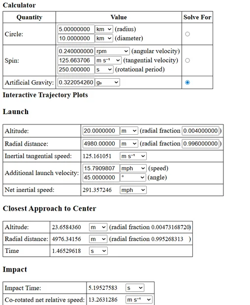

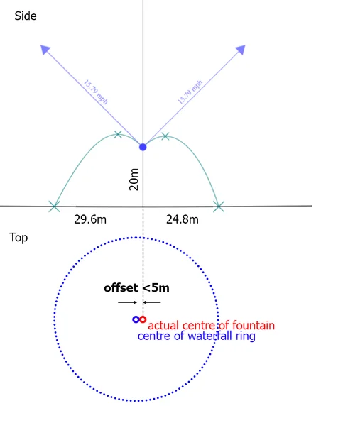

Trying to work this out for myself using this calculator
For a 20m tall fountain, shooting 45 degree jets all around at 15.79mph, I get a deflection of les than 5m on a ring that's more than 50m in diameter.
I'll try some other params, but this is not looking good.
Here are the numbers I used:
A single straight-up stream would land off-center, so there must be an angle at which a diagonal stream would loop back and land at the launch point.

Yeah, unfortunately, the net result is that the landing point (or ring) is merely unilaterally shifted antispinward a few metres. Visually, it is no different than if there were a mild breeze.
Quite anti-climatic.
I was hoping for some delightful effect. Maybe even a precession.
I suspect I may have to incorporate a gyroscope, or some other way to create a precession.
That's unfortunate. It would have been cool to have a fountain do something weird and wonderful.

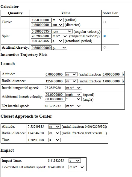

It's beyond mine too, but I found this calculator, which is exactly what I need. Inputs the params of the station, then the fiddle with the launch trajectory and it visualizes the arc for me.

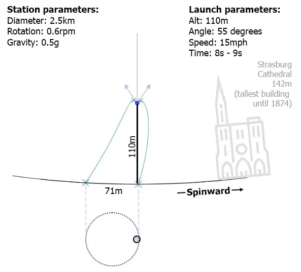

I have upped the gravity to 0.5g (0.3rpm), and I reduced the station diameter to 2.5km.
So the colonists build a tower 110m tall.
The water spouts should probably not be faster than 15mph. 20mph seems to be terminal velocity of a water stream. Any faster and it breaks into droplets anyway.
They can make a fountain whose spinward streams carry them back to the base of the fountain and whose antispinward streams fall 71m away:
Not sure if I'm going to do much better than that with this simplest of fountains.

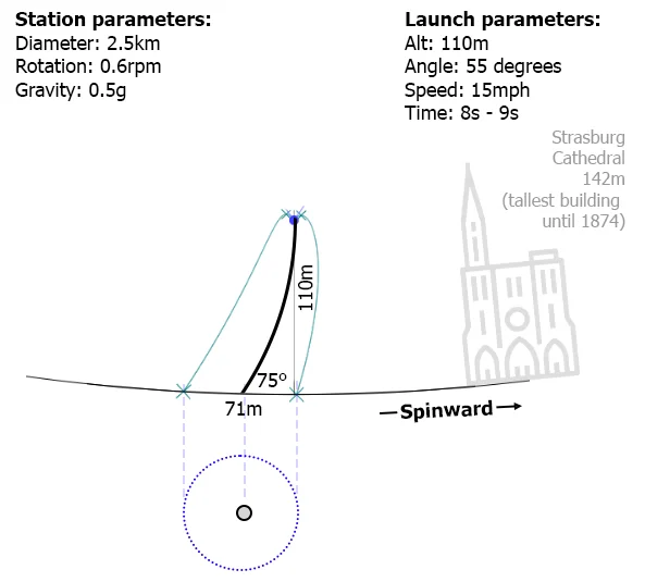

Actually, I suppose this might be more visually impactful. Curve and tilt the tower by about 15 degrees, so the entire fountain is askew:
DaveC426913 said:
Actually, I suppose this might be more visually impactful. Tilt the tower by about 15 degrees, so the entire fountain is askew:
Exotic, certainly! I'd imagine it would be akin to sea-sickness living with these forces on a space station or similar. I'm not sure a skewed fountain would help though! :smile:

My calculations suggest that with your original parameters and a 10m/s launch velocity about 3° off vertical you could have a 16m high closed loop (a single stream that returns to its launch point) 60cm wide at its widest point. With your revised parameters, 10° off vertical gives you a closed loop 40m high and about 5m wide.
Hah. Now we're talking! :smile:
Sorry, the calculator doesn't bare that out.
I must have some parameters wrong.
No, wait, try 100° instead of 80°. You need to launch sightly anti-spinward (or widdershins if we want to sound more mystical).
That doesn't make sense. An object launched antispinward will gain range , not lose it.
DaveC426913 said:
That doesn't make sense. An object launched qntispinward will gain range , not lose it.
Did you try it? I can't get the zoom feature to work on the online calculator on my phone.

Ibix said:
Did you try it?
Thats how i got my two stream fountain diagrams:
- set it to 55 degrees, take a screenshot, - set it to 125 degrees take a screenshot,
- combine.
On my lappie I just click and drag out a zoom box. Doesn't seem to have a mobile equivalent.
