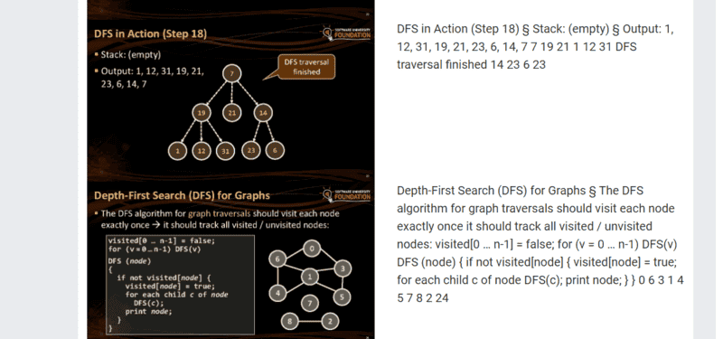

Depth first search

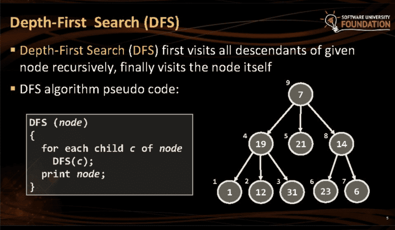

there is a pseudocode below.
The DFS in action doesn't relate to the pseudocode as you can see it. My confusion starts from dfs in action, step 4. I could write essay about it, but you can see it yourself as well and spot that algorithm and dfs in action doesn't match up properly. or is it only me?
This is not a homework, SO I don't know what attempt I need to do. But I got confused and I think this fits here. So..
Full slide is here-:
https://slidetodoc.com/tree-and-graph-traversal-algorithms-breadthfirst-search-bfs/
The algorithm shown is recursive. Starting at the root (node 7), it calls itself on each child node, starting with node 19. At node 19, it calls itself again for each child node, starting at node 1.
Since node 1 doesn't have any children, the function returns to its caller and prints the value at node 1 -- 1. At this point, the current node is the 19 node, which has another child node -- node 12. The function calls itself and visits node 12. Since node 12 has no children, the value at this node is printed -- 12, and the function returns, back to node 19. Node 19 has one more child, so the function calls itself once more to visit node 1. This node has no children, so its value gets printed -- 1.
The function returns, back to node 19, which has no more children, so its value gets printed -- 19. The function returns back to the root, node 7, which has two more children, and continues on in the same fashion to exhaust the tree, going all the way down each branch to the leaf nodes (the nodes that don't have children).
The order of traversal here is 1, 12, 31, 19, 21, 23, 6, 14, 7, the same as shown in the slide.
IDK if I am wrong or right. but IMO order of traversal of dfs should be 7,19,1,12,31,21,14,23,6
You are correct. The order of traversal is as you wrote. The list that I wrote shows the order in which the Python dfs() implementation prints the nodes, which is not the same as the traversal order.
In a nutshell, what the code does is to look at a node. If the node has a child, it looks at that node, and continues in this way until it finds a node that has no child.
The code I showed starts at node 7, the root, visits node 19, then visits node 1. Since node 1 doesn't have any children (it's a leaf node), the code prints 1.
The code then goes to node 12, another child of node 19. Node 12 is a leaf node, so the code prints 12.
The code then goes to node 31, the last child of node 19, and prints 31, since node 31 is also a leaf node.
The code then goes back up to node 19, and prints its value. At this point, the subtree headed by the 19 node has been completely traversed, and the code continues on to the other two subtrees under the root node.
The order in which the nodes are printed is 1 12 31 19 21 23 6 14 7
The order of traversal is 7 19 1 12 31 21 14 23 6
output=======>node (what does this mean? the output should be traversal as I said above am I missing sth?)
The numbers shown in your slide of the tree are not the order of traversal -- they represent the order in which node values are printed. I hope that my explanation in my previous post clears up the difference between traversal order and order in which node values are printed.

At this point, the left subtree has been processed.
The code returns to the 7 node, and in a like manner processes the middle subtree, and the right subtree, and eventually processes the root of the tree, node 7.I added a few lines of code to what I posted previously to help explain what the code does. The extra lines I added keep track of how many times dfs() gets called, and when this function returns to its caller (which most of the time is itself).
Code:
Call to dfs() #1, node = 7
Call to dfs() #2, node = 19
Call to dfs() #3, node = 1
Returning from dfs()
Call to dfs() #4, node = 12
Call to dfs() #5, node = 31
31
Call to dfs() #6, node = 21
Call to dfs() #7, node = 14
Call to dfs() #8, node = 23
23
Call to dfs() #9, node = 6
6 Returning from dfs()
14 Returning from dfs()
Hope this helps.
indentation doesn't correct..can you send the code that you ran in your laptop?
There was more to it than just indentation. Anyway I have looked at this again, those slides are terrible. Here is some code that attempts to explain it better (edited with some improvements regarding pre/postordering etc.
Python:
# The slide is called 'depth first search' but the code actually
# performs a traversal, not a search, so I have named it accordingly
# also respecting the convention that function names should be verbs
# (and so not depthFirstTraversal).
def traverseDepthFirst(graph, nodeIndex, visited = []):
    """ Recursively traverse a graph depth first.
    Returns a preordered list of the indices of visited nodes.
    graph - the graph (a list) of nodes; each node is a dict with
            entries 'value' and 'children'.
    nodeIndex - the index of the current node.
    # If we have already visited the node the graph must be recursive
    # which is not allowed for a simple graph.
    if nodeIndex in visited:
        raise Exception('The graph must not be recursive')
    node = graph[nodeIndex]
    # For a preordered list append now and print it if you want to.
    visited.append(nodeIndex)
    # print('Pre', node['value'])
    for childIndex in node['children']:
        traverseDepthFirst(graph, childIndex, visited)
    # For a postordered list append now and print it if you want to.
    # visited.append(nodeIndex)
    # The original code printed a postordered list so we will do the
    # same.
    print('Post', node['value'])
    # Return the populated list.
    return visited
Here is a demonstration, using the same graph as in the slides:
Python:
testGraph = ([
    None, # Node 0: not used.
    {'value': 1, 'children': []}, # Node 1.
    {'value': 12, 'children': []}, # Node 2.
    {'value': 31, 'children': []}, # Node 3.
    {'value': 19, 'children': [1, 2, 3]}, # Node 4.
    {'value': 21, 'children': []}, # Node 5.
    {'value': 23, 'children': []}, # Node 6.
    {'value': 6, 'children': []}, # Node 7.
    {'value': 14, 'children': [6, 7]}, # Node 8.
    {'value': 7, 'children': [4, 5, 8]}, # Node 9.
# Traverse the graph starting at the head (node 9).
traversed = traverseDepthFirst(testGraph, 9)
print(traversed)
for i in traversed:
    print('Node', i, ':', testGraph[i]['value'])
Which outputs:
Code:
Post 1
Post 12
Post 31
Post 19
Post 21
Post 23
Post 6
Post 14
Post 7
[9, 4, 1, 2, 3, 5, 8, 6, 7]
Node 9 : 7
Node 4 : 19
Node 1 : 1
Node 2 : 12
Node 3 : 31
Node 5 : 21
Node 8 : 14
Node 6 : 23
Node 7 : 6

pbuk said:
There was more to it than just indentation. Anyway I have looked at this again, those slides are terrible. Here is some code that attempts to explain it better:
Python:
    node - the current node.
    # If we want to print the node it should be done here before
    # we traverse its children.
    # print(node)
    for childIndex in graph[nodeIndex]['children']:
    # Printing the node here is wrong.
    # print(node)
    return visited
Python:
testGraph = ([
print(traversed)
for i in traversed:
Which outputs:
Code:
Node 9 : 7
Node 4 : 19
Node 1 : 1
Node 2 : 12
Node 3 : 31
Node 5 : 21
Node 8 : 14
Node 6 : 23
Node 7 : 6
this code doesn't really runs in my laptop vs code idk why ...shows some error.
What error? It works when copied into my PC, and in this repl.
very last question.
in the slide instead of printing visited, we have printed node...what does that mean? shouldn't output of depth first search be how we traverse? i m not getting this last point.
very last question.
Well now we have introduced a disconnected cyclic graph which does not have any ordering so it doesn't matter. These slides don't explain anything well.
bro these were the best slides i found on internet.
