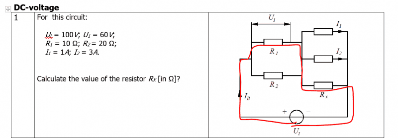

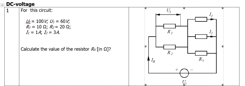

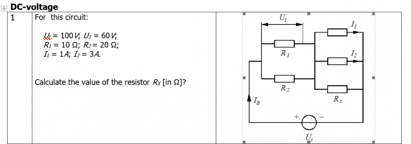

There is not really a relevant attempt at a solution. I do however have the following question: According to the solutions and some reverse 'engineering' I found out that the voltage across R2 is the same as U1 = 60V. It's been years since I've done electrical engineering and I need to refresh my brain. It looks as if though U1 is across both R1 and R2.
The equation for the solution:
[itex]R_x = \frac{U_t - U_1}{\frac{U_1}{\frac{R_1 \cdot R_2}{R_1 + R2}} -I_1 - I2}[/itex]
I'm not quite sure what's going on here..
From what I understand is that the voltage which is 'left' from passing through R1 and R2 is used to calculate the resistance of Rx. So Rx = U/I where U = U_t - U_1. How is that possible? What about the other parallel connected resistors?
Furthermore, in the denominator of the equation I1 and I2 are subtracted from a calculated current. This is where the confusion of the first part of my question comes back. It's as if though the current which would come out of a compound resistor of R1 and R2 is equal to the Voltage across R1 divided by the compound resistance... WHAT?! Am I losing my mind?
EDIT:

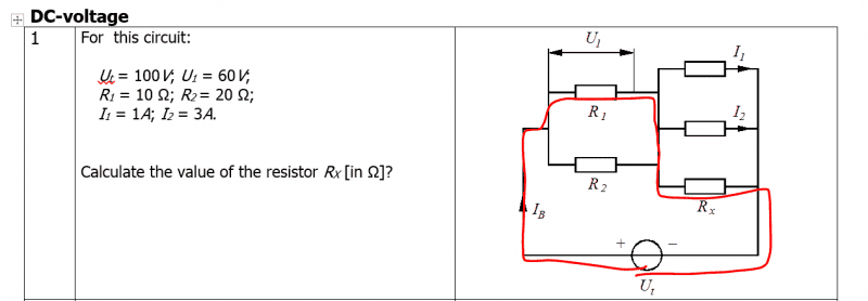

I think this is what's going on:
Still not sure how the current is calculated from which I1 and I2 are subtracted:
[itex]\frac{U_1}{\frac{R_1 \cdot R_2}{R_1 + R2}} -I_1 - I2[/itex]
As in, I don't understand how that's valid.

That is correct. R1 and R2 are in parallel so they must share the same potential difference.

Note that the other three resistors are also in parallel so they too must share a common potential difference. Here it is equal to Ut - U1, the source voltage less the drop across R1||R2. As you say, it's "what's left" of the starting voltage Ut after passing through R1||R2.
The current that passes through R1||R2 (your "calculated current") is the total current that reaches the three parallel resistors. That's the first term in the denominator of the expression. That current will split into three parts, one for each resistor. So ##I_1##, ##I_2##, and let's call it ##I_x## through ##R_x##. The current ##I_x## must be equal to the total current less the other two.

The sum of the currents through R1 and R2, or equivalently, the current through R1||R2, must equal the total current ##I_B## supplied by the source since these two resistors represent the only paths for ##I_B## to reach the rest of the circuit.
You are given the resistor values of R1 and R2 as well as the potential drop across them. So you can work out their currents individually or, after parallel-combining them, the total current through their equivalent resistance. The latter is what was done in the given expression. They could also have written:
##\frac{U_1}{R_1} + \frac{U_1}{R_2} - I_1 - I_2##
Sum of current in 1st parallel branch=2nd branch.
thank you gneill! I can now solve the rest of the problems with a breeze!
