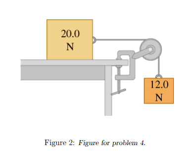

Hello,
I am confused about a problem regarding work done and pulleys. I am confused mainly by the last two, but not 100% confident in the first two either.
1. Homework Statement
Two blocks are connected by a very light string passing over a massless and frictionless
pulley (Figure 2). The 20.0 N block moves 75.0 cm to the right and the 12.0 N block moves
75.0 cm downward.
(image attached)
Find the work done on
(a) the 20.0 N block if there is no friction between the table and the 20.0 N block.
(b) the 12.0 N block if there is no friction between the table and the 20.0 N block.
(c) the 20.0 N block if µs=0.500 and µk=0.325 between the table and the 20.0 N block.
(d) the 12.0 N block if µs=0.500 and µk=0.325 between the table and the 20.0 N block.
For case (a) the force that is moving the [itex]20.0N[/itex] block is the weight of the [itex]12.0N[/itex] block. The work done on the [itex]20.0N[/itex] block is therefore [itex]F x d = 12 x 0.75 = 9 Nm[/itex]
For case (b) I think I can find the work done by finding the change in gravitational potential energy of the [itex]12.0N[/itex] block which is [itex]mgΔh = -9 Nm[/itex].
I think this is correct, to expect the net work done to be [itex]0[/itex], since there is no friction which is non-conservative.
However, for question (c), I am confused about using the coefficient of static friction.
The [itex]20N[/itex] box will move if the static friction force is less than [itex]12N[/itex]. [itex]μn= 10N[/itex] so the net force in the [itex]x[/itex] direction is [itex]2N[/itex].
Now I know the box will move, but is this information relevant to the rest of the question?
The kinetic friction force comes to be [itex]f_{k} = \mu_{k} N = 6.5N[/itex], so the net force when the box is moving is [itex]5.5N[/itex], and thus the work done on the [itex]20N[/itex] box is [itex]w = f x d 4.125N[/itex].
I think the work done on the [itex]12N[/itex] box is still [itex]-9Nm[/itex] because it's change in GPE is still the same, it just changes more slowly.
I know this is a bit of a ramble, but i'd really appreciate it if you could confirm whether my thoughts make sense.
Thanks!
Both the parts are wrong .I haven't checked other parts yet .
In a) force acting on 20 N block is the tension in the string attached to it ,not the weight of the hanging block .
In b) the change in GPE is not equal to the work done .
Draw FBD of the two blocks and write Newton's 2nd Law separately.

Thanks for the response.
I have calculated the tension in the string to be [itex]0.76 N[/itex], by using Newton's second law and simultaneous equations. The work done on the 20N block is therefore [itex]w = f*d = 0.57Nm[/itex]
The net force on the [itex]12N[/itex] block is equal to [itex]12 - T = 11.24N[/itex], thus the work done is [itex]w = f*d = 8.43Nm[/itex]
If this is correct I shall try and apply it to the other parts of the question.
Thanks for your help.

This is incorrect .Recheck your calculations.
I see you have edited your response . Your initial response in post#3 was correct .
Are you sure?
I changed my answer because I used the weight of the block rather than the mass. My new results were found by using 20/g and 12/g in exactly the same equations.
Using 20/g and 12/g as masses should give you T = 7.5N .
Fx = 20/g * a = T
Fy = 12 - T = 12/g * a
12 - 12/g * a = 20/g * a
a = 0.375 ms^-2 Sub this value into top equation.
20/g * a = T = 0.76N
BOAS said:
Fx = 20/g * a = T
I think it should be a = 3.75 ms-2 .
Ah - you are correct, though I'm getting 3.68ms^-2, using g=9.81ms^-2.
Algebra error. Thanks!
