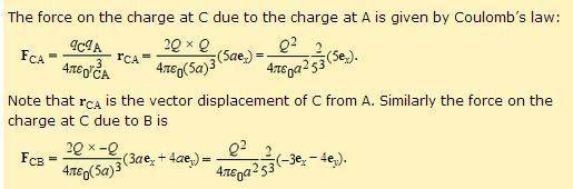

2 questions regarding the answer I have been given for this problem. Attachments are the problem & relevant worked answer I disagree with.
Problem
Three charges are arranged in the xy-plane as shown in attachment. A charge Q is at the point A with (x, y) coordinates (–2a, 4a), a charge –Q is at the point B which is the origin (0, 0), and a charge 2Q is at point C with coordinates (3a, 4a).
Find an expression for the force FC on the charge at C due to the other two charges and hence determine the magnitude |FC| of the force and the unit vector that specifies the direction of FC
Coulomb's law
F = q1 q2 / 4 ∏ ε0 r123 rhat12
F = ke q1 q2 / r123 * rhat
where ke = 1 / 4 ∏ ε0
FCA = 1/4∏ε0 qC qA / rCA3 * rCA
FCA = ke 2Q Q / (5a)3 * (5a ex)
OK, but then goes to
FCA = ke Q2 / a2 * 2/53 * (5a ex)
probably simple algebra but can't see how (5a)3 goes to a2 &53
Next query is regarding
FCB = ke * 2Q * -Q / (5a)3 * (3aex + 4aey)
How can the denominator be (5a)3 too, surely this is √20
Please assure me (or otherwise) that it's not (5a)3
Thank you
There's an "a" in the numerator which leaves a2 in the denominator.
Remember that rCA is the vector from C to A and is not the position vector of A
