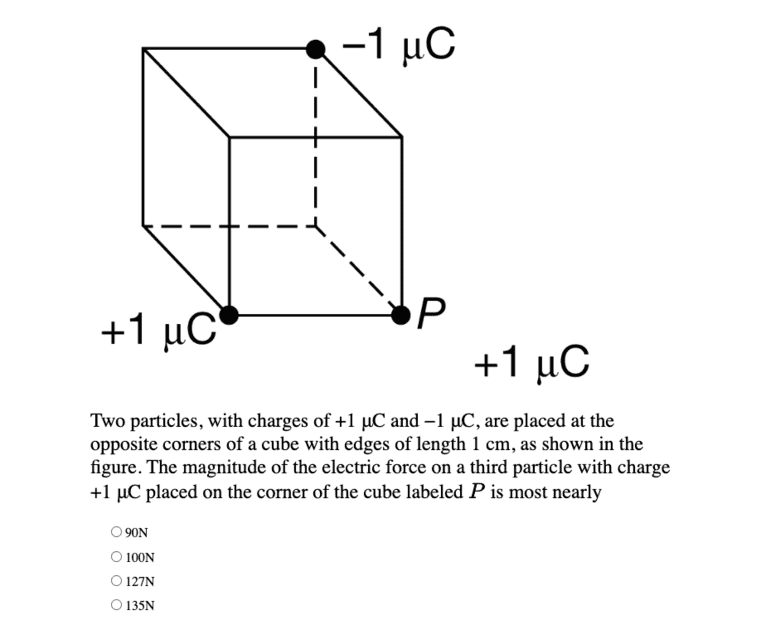

Coulomb law F_e = kq1q2/r^2

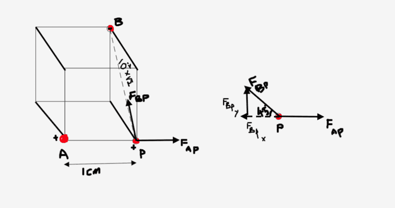

There are three charges with +1 μC and −1 μC, are placed at the opposite corners of a cube with edges of length 1 cm, and the distance from P to B is 1cm 2. I labeled them as A, P, and B, which is shown in the diagram below. Since we need to find the magnitude of the charge at point P and the charge at point P is +1 μC, it exerts an attractive force on point B and a repulsive force on point A. I've indicated the FBD below. Using Coulomb's law, we get
Fe=kq1q2r2
∑Fx=FBPcos45+FAP
∑Fx=91
∑Fy=FBPsin45
∑Fy=45.5N
Using Pythagorean we get,
Resultant magnitude of electric force = 101.7N
I did something wrong here. Can anyone point out where I made the mistake?
Thank you!

Are you sure that force ##\mathbf{F}_{BP}## has a nonzero x-component?

Does that mean F_BP cancels with F_AP since they are in opposite directions?

The equation ##\sum F_x = F_{BP}\cos 45^o + F_{AP}## is not correct.
Can you see that the vector ##\mathbf{F}_{BP}## is perpendicular to the vector ##\mathbf{F}_{AP}##?
paulimerci said:
∑Fy=FBPsin45
∑Fy=45.5N
##F_{BP}\sin 45^o \neq 45.5 N##. What value did you get for ##F_{BP}##?
Does the vector ##\mathbf{F}_{BP}## have a z-component as well as a y-component?
In your diagram, you didn't indicate the directions of the x, y, and z axes.

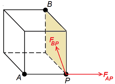

The key is to realize that the vector ##\mathbf{F}_{BP}## is perpendicular ##\mathbf{F}_{AP}##.
If you see that the two vectors are perpendicular, then it should be easy to find the magnitude of their sum. You don't need to consider x, y, or z components.

##\mathbf{F}_{BP}## lies in the face of the cube that is shaded yellow.
The edge AP of the cube is perpendicular to the yellow face.
Imagine looking at the cube so that you are looking directly at the yellow face.
Imagine what the direction of ##\mathbf{F}_{AP}## would be in this picture.

I think I understood what you said. So the magnitude of the electric force is 128N?

##F_{AP} = 91N##
##F_{BP} = 91N##
Using Pythagorean, the net magnitude of electric force at point p is 128N.

The distance between B and P is greater than the distance between A and P. So, shouldn't ##F_{BP}## be less than ##F_{AP}##?

##F_{BP} = 45.5 N ## and ##F_{AP} = 91N##.
Thereby the magnitude of electric force at point P is 102N.

OK. You have the solution. Using k = 9.0 x 109 Nm2/C2 would give 101 N. But the data in the problem is stated to only one significant figure! Your answer is close enough to pick out the correct answer in the multiple choice.

The answer is close to 100 N. Thank you @TSny for your great help!
