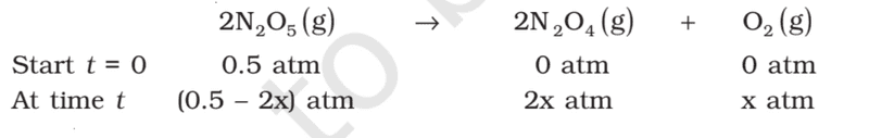

AH okay I got it. so I gotta use something like an ICE table. like this:
that leaves me with this equation: 1/2 (100) ln( 0.5/0.476)= k, solving we get k= 2.46 x 10^-4 1/s, however the answer is given to be 4.92x 10^-4, which is surprisingly double of the k I have calculated..
