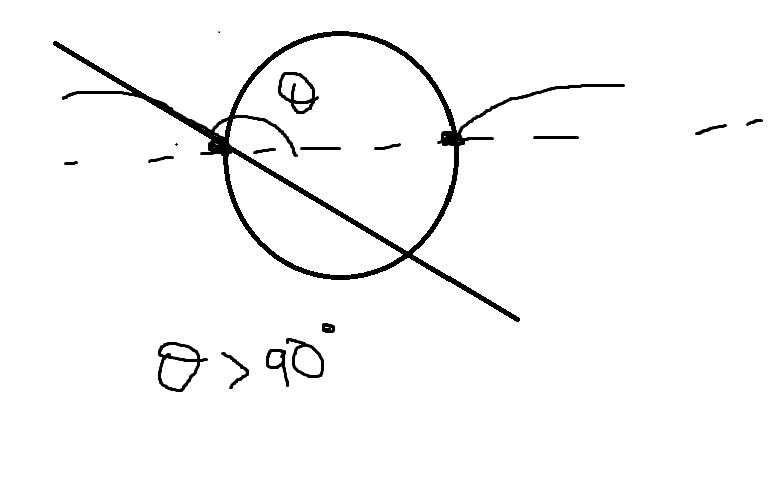

palaphys said:
@Steve4Physics View attachment 359594
is this an accurate diagram? As the meniscus becomes flatter and flatter, eventually the contact angle seems to tend to 180. I do not understand how this is different from a zero contact angle
ohh I get it now, this diagram is incorrect. rather,
Hand-drawn diagram of a sphere touching a vertical wall at a contact point, with a tangent line labelled meniscus and the angle theta sub c marked between the wall and the tangent line.
this must be the right way of representing an obtuse contact angle.

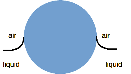

Diagram of a blue sphere with thin black curved lines meeting its left and right sides, each labelled air above and liquid below, showing a contact angle near 180 degrees.
In the above diagram:
Contact angle is about zero.
Liquid is pulled upwards by sphere.
So (Newton’s 3rd law), sphere is pulled downwards by liquid.
I.e. force on sphere is downwards.

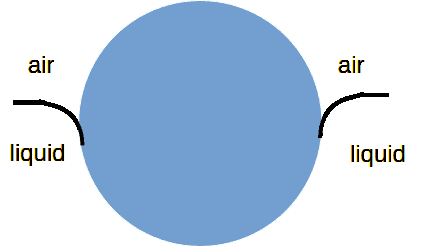

Diagram of a blue circle with a thin black curved line meeting its left and right edges, each labelled air above and liquid below, showing a contact angle at the surface.
Contact angle is about 180##^o##..
Liquid is pushed downwards by sphere.
So (Newton’s 3rd law), sphere is pushed upwards by liquid.
I.e. force on sphere is upwards.

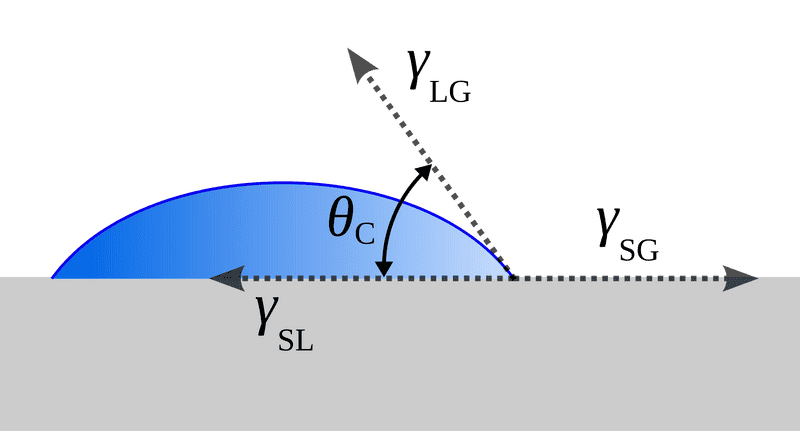

Okay, now this is much more clearer. I still have another question. What about the other interfacial surface tensions, like the solid-air interfacial tension and the liquid-air interfacial tensions? Asking in a sense similar to this
Diagram of a sessile liquid droplet on a solid surface showing the contact angle θC and three interfacial tension vectors: γLG at the liquid-gas surface, γSG along the solid-gas surface, and γSL along the solid-liquid interface.
Don't know what what the question means. Simply asking "What about ..." is too vague. What exactly do you want to know?
Note that there is no such thing s 'interfacial surface tension'.
Surface tension is a property of a single substance.
The interfacial force between different substances is called the interfacial tension (not interfacial surface tension).
Not something I know much about, so will leave thread at this point.
