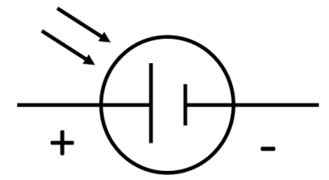

The symbol for photovoltaic cell is given below. The cell supplies current of magnitude ##I## at em.f. ##E##. Draw a diagram to show how two of these cells may be connected so that the combination supplies a total current greater than ##I## at the same e.m.f
Series and Parallel
The answer from my teacher is two of these photovoltaic cells are connected in parallel. I can understand the parallel connection will produce same e.m.f but I don't understand why the total current will be greater than ##I##.
I imagined one of the cell connected to a lamp. The current through the lamp will be ##I##. And now there are two of these cells connected in parallel and I imagine a lamp also connected parallel to the two cells. The voltage on the lamp won't change so the current pssing thorugh it will also still be ##I##. What I think will change actually is the current provided by the cells, which is now becomes ##\frac I 2## but the total current would still be ##I##
Am I wrong? Thanks
The voltage quoted for a solar cell is open circuit. As soon as it is connected up as a circuit and current flows the voltage falls. Having cells in parallel will reduce the decline.
Maximum power output is achieved by matching the load to the cell's effective internal resistance. See https://www.alternative-energy-tutorials.com/solar-power/measuring-the-power-of-a-solar-panel.html.
I agree that putting two in parallel will not in general double the total current, but if the load is doubled at the same time it will.
I understand this part. This is to fulfill the "at the same e.m.f" part.
But will putting two in parallel increase the total current to be larger than #I#?
And I don't understand why doubling the load will double the current. I thought since the value of e.m.f does not change (or just change a little bit due to potential drop in internal resistance), doubling the resistance will make the current becomes half of initial
Thanks

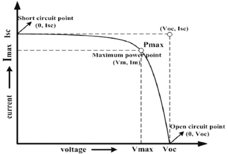

I think you are assuming that the load resistance doesn't change. In that case you are correct, at the same emf, with the same load resistance, the load current is the same. But as others have said, you will get a small increase in the voltage produced from each of the paralleled PV cells since their current load has dropped. To maintain the same emf as one PV with two in parallel you will have to decrease the load resistance so that each PV is doing exactly what the previous single cell was doing. This assumes no change in the illumination, of course. Check out a typical PV V-I curve:
I get the idea. The parallel connection should be accompanied by change in load resistance.
Thank you very much for the explanation haruspex and DaveE
