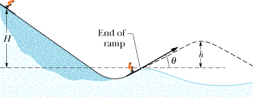

A 78 kg skier starts from rest at a height of H = 29 m above the end of the ski-jump ramp (Figure 8-39). As the skier leaves the ramp, his velocity makes an angle of 28° with the horizontal. Neglect the effects of air resistance and assume the ramp is frictionless.
(a) What is the maximum height h of his jump above the end of the ramp?
____ m
m = 60 kg
H = 20 m
theta = 28
h = ?
I used the equation
Ki + Ui = Kf + Uf
(Initial/Final Kinetic + Potential Energy)
1/2mVi^2 + mgyi = 1/2mVf^2 + mgyf
1/2(0)^2 + (9.8)(20) = 1/2m(Vf)^2 + gh
But I don't know how to get Vf. Where do I use theta?
The problem must be done in two parts. Use the conservation of energy equation you have written to find vf which is the speed of the jumper at the time he leaves the ramp. H=29m according to your problem statement, not 20 m. And yf=0, not h, because "f" refers to the time when the jumper is at the end of the ramp and the height he is at at that point (when his speed is vf) is 0. Once you have found vf, you use the angle to find the x and y components of the velocity. This can then be used with either kinematic equations or more energy conservation equations to find the max height h.

Your value of Vf is incorrect, probably because you left the term 'm' in your equation. Also, 'gh' shouldn't be there in the RHS, because the diagram clearly shows them at the same level.
Using mgh = 1/2 m v^2 (because initially, it has only potential energy, before going off ramp, only kinetic energy), you get
v = (2gh)^(1/2) = 20 m/s (approx).
Now, using this in equation for maximum height attained for projectile motion:
Max height = ((v sin theta)^2)/(2g)
The above can be derived from the parametric equation of projectile motion. Plug the values in, and you get max height = ((20 x sin 28 degree)^2)/(2 x 9.8)) = 4.45 m.
