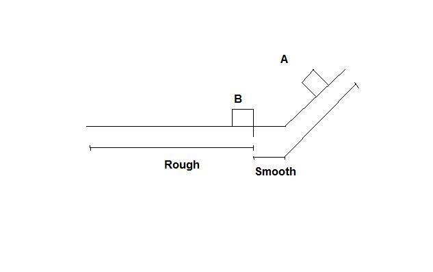

See the figure-
The block A collides inelastically with the block B. I have seen in 2 of my books that they apply conservation of momentum in such problems along x-direction. According to me, since there is an external frictional force acting, the linear momentum is not conserved.
Is it that they consider Earth + A + B to be the system and ignore the velocity of the Earth ?
Please throw some light on this.

The friction does transfer some of the momentum to the table (or whatever). Simpler experiment - put a book on the table and give it a push (impart momentum) and it will soon stop (momentum transferred to table).
As you know, momentum is not conserved after the collision, and we have to use the work energy theorem instead.
But during the collision, the friction force is non-impulsive, ie it acts for such a short time that its effect can be ignored …
it has no effect on the sudden change in momentum …
so momentum is conserved. :smile:
So ideally the momentum is not conserved?
Yes, but well below the threshold of accuracy with which you could measure the velocities. :wink:
Is this approximation same as the situation when we ignore the momentum of the Earth by considering A+B+Earth as our system?
I don't think so (I don't really see the analogy :redface:).
But that would violate mathematical laws. You must get the same equation by two different methods. Otherwise either one of them is wrong.
Momentum is conserved. You change the momentum of the Earth itself. But that amount is so small compared to Earth's total momentum that you could never measure it. So for all practical purposes the momentum is treated as "lost". Think of it this way. If you pour a glass of water into the ocean you increase its volume. But if you go to any station that measures sea level you will never ever observe a change in sea level because of your action. It is the same with the momentum of a sliding object on the Earth. The momentum is still there, you just can't measure it.
