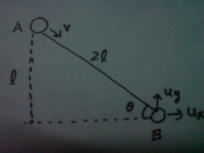

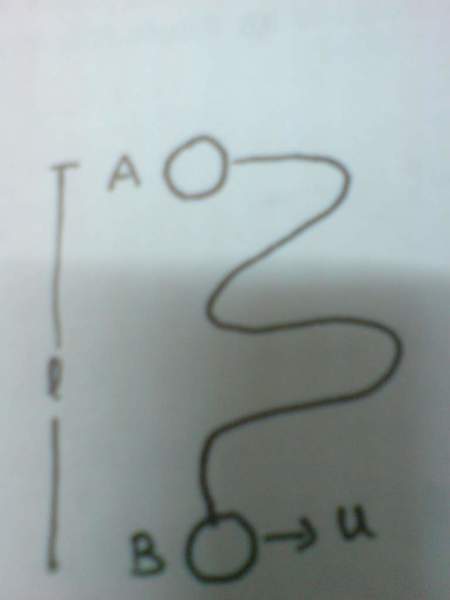

Two particles A and B each of mass m are attached by a light inextensible string of length 2l .The whole system lies on a smooth horizontal table with B initially at a distance l from A.The particle at end B is projected across the table with speed u perpendicular to AB.Find the velocity of ball A just after the jerk ?
The particle at A feels jerk when the string becomes taut.When this happens the angle θ wiill be 30° .
V=velocity of A after the jerk
[itex]u_x[/itex] = x component of velocity of B after the jerk
[itex]u_y[/itex] = y component of velocity of B after the jerk
Using conservation of momentum in y direction we have [itex]u_y[/itex]=vsin30° =v/2
Using conservation of momentum in x direction we have mu = mvcos30°+m[itex]u_x[/itex]
Applying conservation of energy we have
[itex]\frac{1}{2}mu^2 = \frac{1}{2}mv^2+\frac{1}{2}m{u_x}^2+\frac{1}{2}m{u_y}^2[/itex]
Putting the values of [itex]u_x[/itex] and [itex]u_y[/itex] in the above equation and solving
we get v=[itex]\frac{\sqrt{3}}{2}u[/itex]
This is not the correct answer ...Please guide me where am i getting it wrong .

Tanya Sharma said:
Applying conservation of energy we have …
This is a collision.
Energy is never conserved in a collision unless the question says so!
Hint: you obviously need some other equation … in which direction do you think A will move? :wink:​

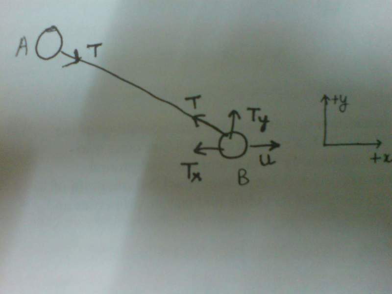

Lets focus on B's motion ...I agree that the acceleration of B will be along the string ...Now let's resolve this acceleration in two components . One along the y direction and the other along the x direction...The component along the x direction will decelerate B and the one along y direction being normal will change direction of B. Am i right?
But then A and B needs to have same velocity along the string .Isnt it??
not really following this :confused:
mass times acceleration of A will equal minus mass times acceleration of B
no, there could be rotation
The component along the x direction will decelerate B and the one along y direction being normal will change direction of B. Kindly see the attachment.The tension will act along the string .This tension will have two components ,one along x and other along y direction.The one along y direction will be normal so will change only direction .The other along x direction will decelarate B .
tiny tim...i am absolutely confused...I have tried hard on the problem...Kindly explain the motion of the two particles in this particular problem...
I understand that accelaration will be along the string but what about the velocity of B ?
A and B continue at distance 2l apart.
The string joining them will rotate, but will remain taut (of length 2l).
So d/dt (rA - rB).(rA - rB) = 0, ie (vA - vB).(rA - rB) = 0. :wink:

Instead of conservation of energy, the angular momentum is conserved in addition to conservation of linear momentum. Write up the equations for the x, y components of momentum and the angular momentum before the jerk and after it.
You have one more equation which follows from the constant length of the string and Tiny-Tim suggested to you: (vA - vB).(rA - rB) = 0

Three identical balls are connected by light inextensible strings with each other as shown and rest over a smooth horizontal table .At the moment t=0,ball B is imparted a velocity.Calculate the velocity of A when it collides with ball C.
it that problem, you are given the (initial) velocity after the jerk, but in this problem, you are given the velocity before the jerk
energy is never conserved during a jerk, but it should be conserved in the smooth motion that follows the jerk :smile:
tiny tim and ehild ...I have attempted the problem ...Kindly check my work
Consider A as the origin and +x axis to be rightwards and +y axis to be downwards
u = initial velocity of B rightwards
V = velocity of A after the jerk
[itex]W_x[/itex] = x component of velocity of B after the jerk
[itex]W_y[/itex] = y component of velocity of B after the jerk
[itex]r_A[/itex] = position vector of A
[itex]r_B[/itex] = position vector of B
Applying conservation of momentum in x direction we have
[itex]mu=mVcos30° + mW_x[/itex]
[itex]W_x=u-\frac{\sqrt{3}}{2}V[/itex] (1)
Applying conservation of momentum in y direction we have
[itex]0 = mVsin30°+mW_y[/itex]
[itex]W_y=-V/2[/itex] (2)
[itex]V_A = Vcos30°\hat{i}+Vsin30°\hat{j}[/itex]
[itex]V_B=W_x\hat{i}+W_y\hat{j}[/itex]
[itex]r_A=0[/itex]
[itex]r_B=\sqrt{3}\hat{i}+\hat{j}[/itex]
Since string length remains constant we have [itex](V_A-V_B).(r_A-r_B) = 0[/itex]
[itex][(Vcos30°-W_x)\hat{i}+(Vsin30°-W_y)\hat{j}].[\sqrt{3}\hat{i}+\hat{j}] = 0[/itex]
[itex]\sqrt{3}(Vcos30°-W_x) + (Vsin30°-W_y) = 0[/itex]
Putting the values of [itex]W_x[/itex] and[itex]W_y[/itex] from eq 1 and 2 we get
[itex]\sqrt{3}[\frac{\sqrt{3}}{2}V-(u-\frac{\sqrt{3}}{2}V)] + (V/2+V/2) = 0[/itex]
[itex]\sqrt{3}(\sqrt{3}V-u) + V = 0[/itex]
[itex]4V-\sqrt{3}u = 0[/itex]
[itex]V=\frac{\sqrt{3}}{4}u[/itex]
Tania,
Although your solution corresponds to the mirror image of the figure in the first post, it looks correct :smile:
You supposed that particle A gains velocity in the direction of the string after the jerk. That looks straightforward, but I would not be so sure in it. Anyway, I got the same result as you assuming conservation of both momentum and angular momentum. You need only a little correction: The velocity of particle A was the question, and you gave the speed.
Anyway, it is a nice work, congratulation!
