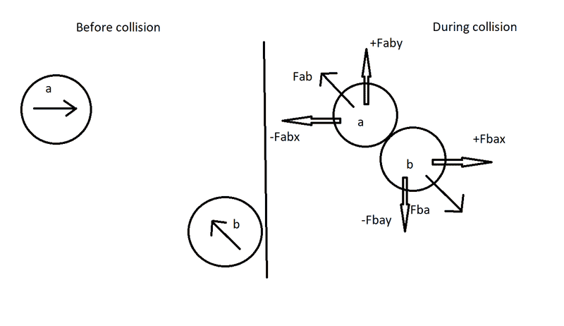

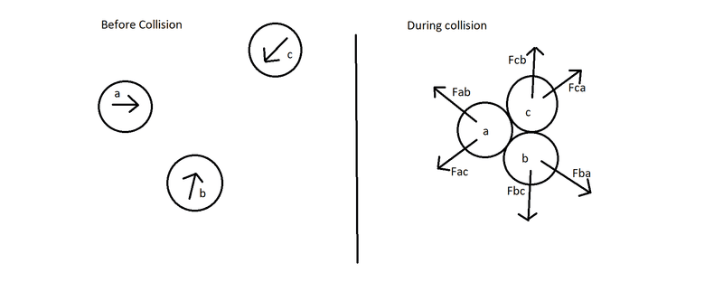

That is what I mean. I get it, It can only happen if there are only pair collisions(between 2 particles at a time) inside a system but that is not what happens.
jbriggs444 said:
The proviso about collisions being on the same line is not needed.
Newton's third law applies in the x direction, the y direction and the z direction separately. As a result, momentum is conserved in the x direction, the y direction and the z directions separately.
One does not need the lines of action of all of the x-direction forces/impulses to coincide in order to conserve momentum in the x direction. The position of the line of action of a force is irrelevant for the purposes of linear momentum. It is enough that for each internal impulse there is an equal and opposite internal impulse.
Sorry for replying so late. I was trying to understand. I have made two diagrams. Is that what you mean by no need for position of line of action of a forces to coincide?
(Since the impulses are equal and opposite so all the force components in x and y directions will cancel out)
I have not made components in second diagram since it was getting messy.

No, that is not what I had in mind.
In context, I believe that we are talking about three (or more) bodies. For simplicity, we could call them A, B and C. We have a number of interactions between pairs. For simplicity, we could reduce it to two interactions: AB and AC.
There was an assertion against which I was arguing. Well, not quite an assertion -- a caveat that I claim is not needed. That caveat is boldfaced here:
"If the interactions all have lines of action that line up on a single axis and conserve momentum pairwise then total momentum is conserved."
In fact, given nothing but pairwise momentum conservation for each interaction, linear momentum is still conserved. The caveat about lines of action is not needed.This is not to say that the lines of action of the pairwise interaction forces are irrelevant. They are important. One can make the following assertion:
If each pairwise interaction conserves momentum and has a line of action that passes through the center of mass of the two interacting bodies then angular momentum is conserved.
More advanced physics students may note that the caveat here about lines of action can be taken as a somewhat corrupted way of saying that "there is no preferred direction" or "the laws of physics are isotropic". This, in turn means that Noether's theorem assures us that there is a corresponding conserved quantity (i.e. angular momentum).
