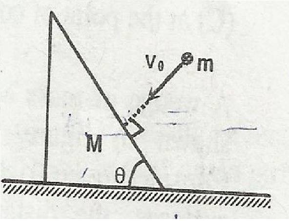

In the figure shown, a ball of mass m collides perpendicularly on a smooth stationary wedge of mass M, kept on a smooth horizontal plane. If the coefficient of restitution of collision is e, then determine the velocity of the wedge after collision.
can we conserve momentum when the collision is partially elastic ?
i wrote→ mV°sinθ= MV + meV°sinθ
is this right??
The ball's velocity after impact is not eV0.
What is the definition of the coefficient of restitution?
this is e...

Kishlay said:
this is e...
OK, except that there should be a minus sign because the relative velocity will reverse.
In the present problem it's a bit tricky to apply because of the different directions involved. You know the relative velocity before collision, but what should you take as the relative velocity afterwards? Any thoughts?
yes... the relative velocity will be respect to ground frame...!

I don't know whether this is still of interest to you, but I have concluded that you cannot solve it using the definition of CoR in the usual way. There is no appropriate relative velocity after the collision. Instead, use the way in which the CoR affects the recovered energy.
Treating the collision as compression of a spring, there comes a point at which compression is a maximum. At that point, the ball and the wedge have the same velocity in the direction of travel of the ball. You can work out (but it's not easy) what fraction of the original KE is now stored as PE. The affect of the CoR being < 1 is that not all of the PE is recovered again as KE. The fraction that is recovered is e2. This allows you to work out how much energy is lost. Fwiw, I get lost energy = ##\frac{(1-e^2)M}{M+m\sin^2(\theta)}##

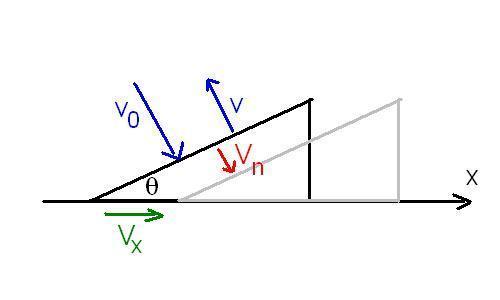

I confirm TSny's result. You have to take only the component of the wedge's velocity normal to its sloping surface. Still not sure I've grasped that intuitively, but it does give the right answer. Your method will not.
Kishlay, see figure attached.
The wedge will move horizontally to the right with speed Vx, but its surface displaces with the normal velocity Vn . If the ball bounces back from the surface with velocity v, the relative speed of separation is |Vn-v|. With the magnitudes, it is Vn+v. So
e=(Vn+v)/v0.You can see that the horizontal speed of the wedge is related to the normal speed of the surface as Vn=Vxsinθ.
Apply conservation of momentum for the x components of the velocities.
You get two equations for v and Vx. Eliminate v, and solve for Vx.
e=(Vn+v)/v0.
i think there will be a -ve sing right?
I meant v the speed of the ball after collision. The relative velocity of the ball with respect to the surface of the wedge is Velocity(ball) - Velocity (wedge). The ball and wedge surface move in opposite direction, so their speeds add, the speed of separation is the sum of speeds Vn and v.
