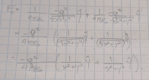

I"m supposed to calculate the force once it's shifted in delta y.
https://drive.google.com/open?id=0B76TBRMyBuffbkVPY3hjZU0xV3M
The picture above is where I always get to before not knowing what to do anymore.
From your image it doesn't look to me like you've added the vectors of the forces properly.
By symmetry only the y-components of the forces survive the vector summation, but you haven't shown how those y-components are determined from the force magnitudes. Your work seems to be taking the full force magnitudes and just calling them y-components. Unless there's something special about your ##\hat{y}## vectors?
What do you need to multiply the force magnitudes by in order to "extract" the magnitude of their y-components?
Likes Decadohedron
I should have called it something else but
##\hat{r}## = rvector/|r| = (0, y)/sqrt(x^2+y^2)
The numerator of what you wrote suggests ##\vec{r} = (0,y)## while the denominator suggests ##\vec{r} = (x,y)##.
The vector ##\hat r = \frac{\vec{r}}{\|\vec{r}\|}## has to have a magnitude of 1. The vector ##\frac{(0,y)}{\sqrt{x^2+y^2}}## clearly doesn't, so the two can't be equal.
Forget about vector notation for right now. By what do you need to multiply the magnitude of the force by to get just the y-component? Note that ##x## won't appear in the final expression because ##x=0## for the middle charge.
Likes Decadohedron

r sin theta would give me that magnitude of y?
I really appreciate the help guys - sorry that I"m being a bit dense at the moment.
If r is the magnitude of the vector of interest and θ is the angle that r makes with the positive x-axis, then yes, r sin(θ) would give you the magnitude of its y-component.
Now, see if you can "construct" sin(θ) from the given geometry using the triangle sides.
Likes Decadohedron
I"m not quite sure what you mean by construct here, so I assumed this
rsin theta = y
sin theta = y/sqrt(d^2+y^2)
So then I taylor expanded 1/sqrt(d^2+y^2) and since it's to the highest order of y, I ended up with
sin theta approximately equals y/dWhich when I put that back into the original force equation I come out with -2q^2y/4piepsilon0d^3
I don't think it matters in this case, but I'd wait to Taylor expand until after you get the expression for the force because the magnitude of the force also depends on ##y##.
Likes Decadohedron
There was no other y in the expression so I figured it'd be safe to Taylor expand then.
Glad I finally got this - thanks to you guys! My head was getting sore from beating it on the desk so much.
