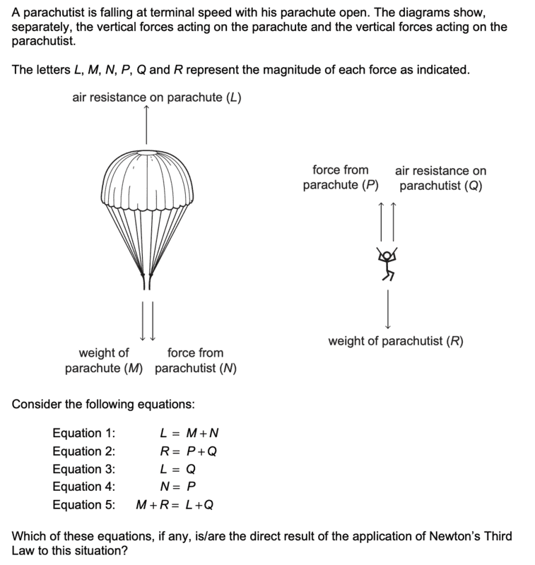

There are a few things I'm not getting about this exercise and related diagram:
-what does "force from parachutist" consists of?
-if the terminal velocity is reached, then ##a=0## which means ##F_{tot}=0##, so shouldn't simply the sum of all forces pointing upwards be equal to the sum of all pointing downwards?

The force from parachutist is just their weight and the weight of all of their gear.
And you are correct, at terminal velocity, there is no acceleration of the parachutist and parachute -- they both fall at the constant terminal velocity. So the sum of all forces is zero in that state.

No, it is the force the parachutist and clothing etc. exerts on the parachute.
Call it the total tension in the ropes that tether the parachutist to the parachute. Note that the upper part of the ropes is in the FBD of the parachute and the lower part of the ropes is in the FBD of the parachutist. Does that help?

But, shouldn’t either ##P=N## and ##M+R=L+Q##?
greg_rack said:
That definitely helped, now I’m understanding the situation much better!
##M+R=L+Q## is " more "second law than third law too me, even if it is true, the question want 3rd Law's implications

Well, the equation is ##P=N## then, right?
greg_rack said:
God, I’ve totally missed it... what a fool!
I was thinking in terms of the second law :)
Yes.
