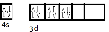

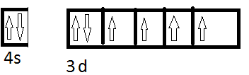

I am confused with the electron configuration of central atoms in complex salts eg. ##[Fe(CN)_6]^{2-}## configuration just Fe atom is
Now the complex is low spin so the configuration becomes,
Now we have 6CN. where will they donate their electrons? Will the donate electrons in the remaining ##e_g## to form ##d^nsp^m## or will they donate electrons in the 4s, 4p and 4d to form ##sp^nd^m## or will they have some other configuration? Can you give some exceptional cases (like for Pt all ligands are strong field and most are square planar)
