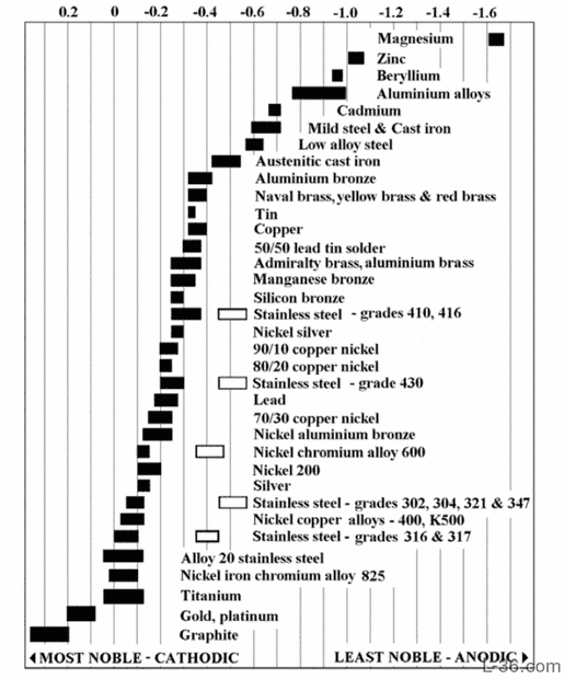

Galvanic series chart of metals and alloys ranked by electrode potential in seawater, from most noble (cathodic) at the bottom to least noble (anodic) at the top, with graphite lowest and magnesium highest.
Imagine now there is a block of copper on top of the block of iron. First, visualize it in the same scenario far away from the coast. We have two dissimilar metals in contact and the atmosphere will be the electrolyte.

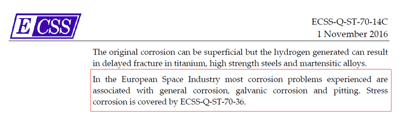

This thread is mainly motivated by the following documents.
  1. ECSS-Q-ST-70-14C (1 November 2016): Corrosion
  2. ECSS-Q-ST-70-36C (6 March 2009): Material selection for controlling stress-corrosion cracking
  3. ECSS-E-HB-32-23A Rev.1 (6 February 2023): Threaded fasteners handbook (I could only find the online version of the 2010 release)
  4. ECSS‐Q‐ST‐70C6 (March 2009): Materials, mechanical parts and processes
So galvanic corrosion is a big issue as you can see in the picture. In working conditions, it has no effect because in space there is no electrolyte. However, it is necessary to ensure that degradation during manufacturing and storage until launch is controlled.

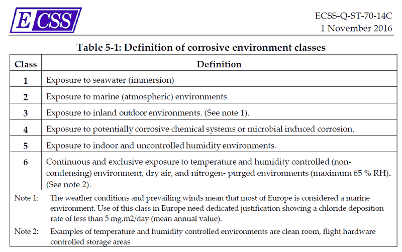

Table 5-1 from ECSS-Q-ST-70-14C defining corrosive environment classes 1 to 6, from seawater immersion to temperature and humidity controlled dry environments, with notes 1 and 2.
Ideally, all products will always be in a class 6 corrosive environment. However, ideal scenarios and reality tend to differ so I'm trying to get a firmer grasp on corrosion.

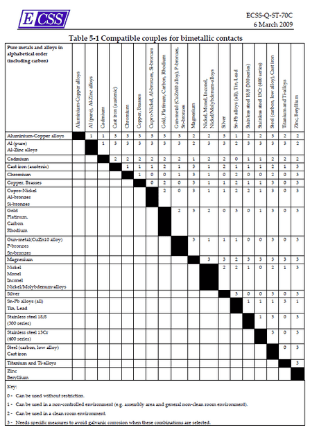

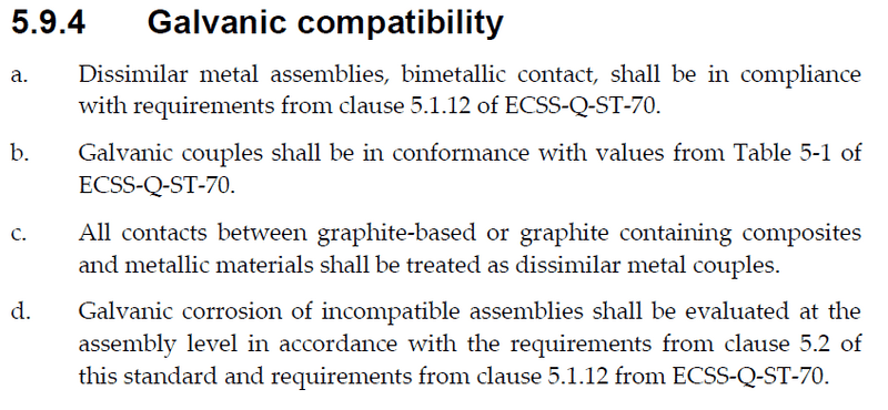

  • Galvanic compatibility is not always respected. According to Table 5‐1 Compatible couples for bimetallic contacts from ECSS‐Q‐ST‐70C (2009), aluminum should not be used in contact with copper without taking special measures. However, it's a common practice to install locking bronze helicoils to avoid galling. It's even recommended in ECSS-E-HB-32-23A Rev.1 (6 February 2016). Even the use of stainless steel fasteners in contact with aluminum is cause for concern. I assume in those cases it's often allowed because the aluminum chunk (the least noble of the couple so the one that will corrode) is often significantly bigger than the helicoil or fasteners so, since the exposed area ratio between the anode and cathode is so big, it's assumed that the corrosion will happen at a very slow rate.
    Screenshot of text titled 5.9.4 Galvanic compatibility with four lettered clauses a to d about dissimilar metal assemblies, galvanic couples, graphite-based composites and galvanic corrosion evaluation.
    Table 5-1 from ECSS-Q-ST-70C: a grid showing which pure metals and alloys are compatible for bimetallic contacts, with numbered ratings 0 to 3 in the cells and a key below.

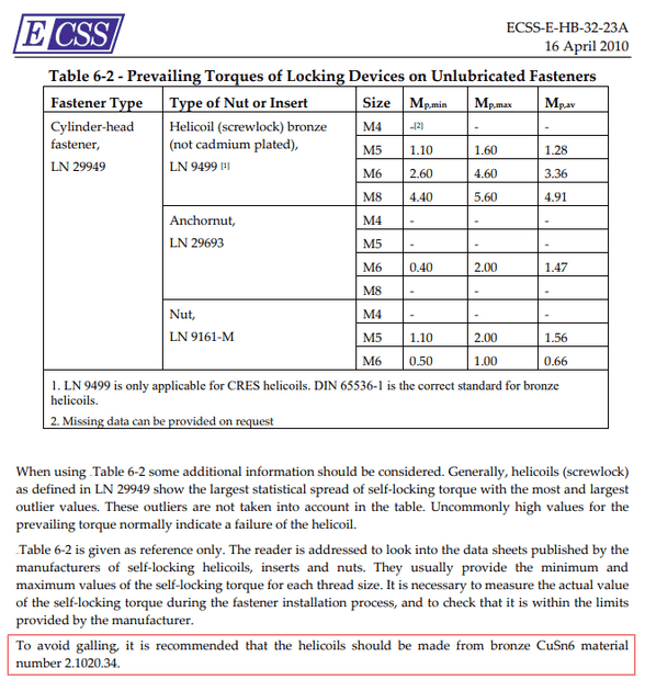

    Table 6-2 from ECSS-E-HB-32-23A listing prevailing torques (Mp,min, Mp,max, Mp,av) for locking devices on unlubricated fasteners, with footnotes and a boxed note recommending bronze CuSn6 helicoils to avoid galling.
    By the way, I find it very annoying the aluminum alloys are not classified as 1000, 2000, etc in Table 5.1. I checked the chemical composition so I believe I know which is which but I'll always live with that doubt.

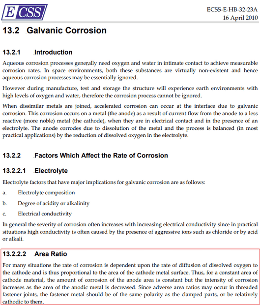

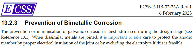

  • Prevention of bimetallic corrosion: One of the alternatives to avoid this corrosion is to avoid electrical contact. I have learned that, in case of opting for this route, it's always preferable to protect the cathode. That way, if the coating is damaged (maybe scratched while assembling the part with screws), the area ratio will still be favorable. However, in ECSS-E-HB-32-23A Rev.1 (6 February 2023) I found the opposite recommendation which makes no sense to me because if the coating fails at a point, corrosion will be focused on that point having a greater impact. An example would be anodizing an aluminum component that will be threaded into place with stainless steel screws.
    Screenshot of an ECSS handbook page showing the ECSS logo, document number ECSS-E-HB-32-23A Rev.1 dated 6 February 2023, and section 13.2.3 'Prevention of Bimetallic Corrosion' with a short paragraph on preventing galvanic corrosion at the design stage.
    Page excerpt from ECSS-E-HB-32-23A, section 13.2 Galvanic Corrosion, covering introduction, factors affecting corrosion rate, electrolyte factors and area ratio.

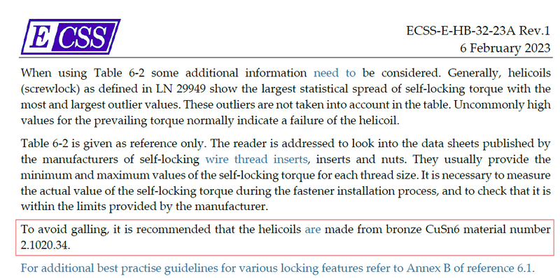

    I must be misunderstanding something about this point because ECSS documentation is written by people way more experienced and qualified than me but I don't see how to marry what I knew already about the prevention of galvanic corrosion and this piece of information.
  • Excerpt from ECSS-E-HB-32-23A Rev.1 on self-locking helicoils, stating they are recommended to be made from bronze CuSn6 material number 2.1020.34 to avoid galling.

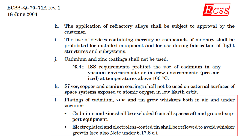

There's a tangential 'gotcha', whisker formation. A known failure mode of certain types of eg semiconductor on-chip connections.
Cost us some very nice digital balances which became unreliable due to 'hairline' growths in force-bridge gap. Scant effect on 'gross' loads,, such as the internal calibration procedure, but could stall if you were adding powder literally fleck by fleck. As I understand it, traces of solvent in lab air locally pin-holed the protective varnish on the force-bridge...

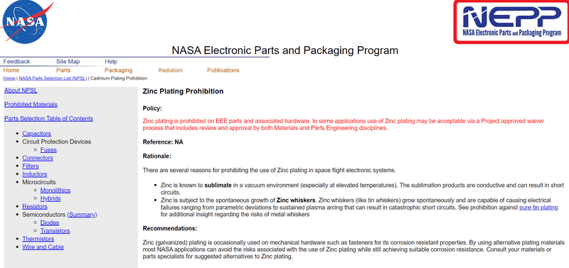

Whysker formation is a known issue in the space industry. It's addressed by different norms such as ECSS-Q-70-71A rev. 1 (18 June 2004) and NASA documentation. Shouldn't be a problem as long as those materials are not used, right?
Screenshot of the NASA Electronic Parts and Packaging Program page titled Zinc Plating Prohibition, with the Policy, Rationale and Recommendations sections.

Separately, low melting point metals are problematic because they can migrate under the right thermal conditions, which is why there are restrictions on their use in vacuo, or certain electronics, especially power electronics which can operation under 'hot' conditions.
Cadmium594.18 K321.18 °C
Lead600.6 K327.6 °C
Zinc692.73 K419.73 °C
Ref: https://angstromsciences.com/melting-points-of-elements-reference

Marine and coastal corrosion is complicated because the electrolyte (seawater, brackish water, rainwater, moisture) changes with seasons and weather. The main concern with seawater, and sea spray, is the halide salts, primary NaCl and MgCl2, the latter of which is very corrosive (see Mg in the galvanic series). The chlorine atom attacks the oxide layer and can break it down such that the protective oxide layer is no longer protective. Near some coast areas, primarily oil refineries and urban areas, is the presence of sulfur compounds, due to sulfur in petroleum, and sulfates and polythionic compounds are also detrimental to corrosion resistance, espcially in conjunction with Cl compounds.
Can you provide what would be the chemical reaction in such a scenario? When I checked iron-copper galvanic cells, it seemed the conditions were more strict than just standing there in electrical contact and exposed to the atmosphere. I mean, if there is no copper available in the atmosphere, how can the galvanic reaction occur?
One could look back in history about the use of iron and copper in ship building, first as nails and later as cladding or covering over the wood, and then as the main structural material, especially for propulsion shafts (most likely steel) and propellers (possibly bronze and less likely a brass). Copper would most likely be in the form of a bronze, but also possibly as an impurity in steels and stainless steels.
https://www.nxymarine.com/blog/the-main-materials-for-marine-propellers-and-the-differences_b22
https://www.copper.org/applications...206-copper-alloys-for-marine-environments.pdf

Certainly the closer to the ocean, the more moisture/humidity provides for damp conditions. At water's edge (tidal zone, splash zone), metal surfaces can be wet some or most of the time, depending on how far horizontally and vertically the metal surface is from the sea-level surface.
https://www.wbdg.org/ffc/dod/cpc-source/waterfront-coastal-structures-knowledge-area
Sea spray is another factor. Salts in solution can be carried on the wind and deposit on metals, which over time build up layers of salt and oxides from corrosion. Even when the spray is absent, the layers of salt and oxides are subject to moisture from rain and importantly from condensation of moisture in the air. One may investigate deliquescence, the process of becoming liquid as a result of absorbing moisture from the air. Salts and porous oxide will adsorb water from the atmosphere as well as experience condensation or precipitation (rain), and so go through cycles of wet and dry, with the corrosion rate increasing during the wet phase. This is also a factor in northern climates around lakes and rivers, especially where salt may be applied to highways and roads.
