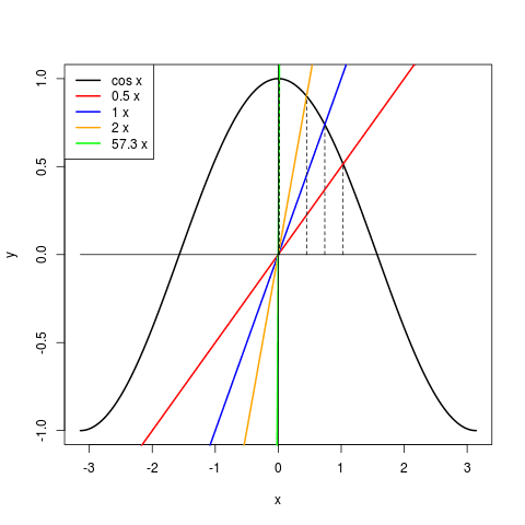

Yes, it will converge to the root(s) of the equation ##kx=\cos x## where ##k## is the number of units per radian. For degrees, ##k\approx 57.3##. The convergence point will differ according to the units. Graphically, it converges to the abscissa of the intersection point between the lines ##y=kx## and ##y=\cos x##. The following image shows the intersection point for units of double-radian, radian, half-radian and degrees (##k=0.5,1,2,180/\pi##). The roots are 0.51, 0.74, 0.90 and 0.9998 respectively.

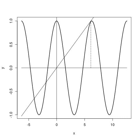

To work out the smallest units at which there will be multiple possible convergence points, we seek the tangent to the cosine curve that passes through the origin, with the point of touching being in the first quadrant. The tangency condition gives us equations ##kx=\cos x## and ##k= -\sin x##, with the second of those equating the gradients. From the first we get ##k=\frac{\cos x}x##. Substituting that into the second gives ##\frac{\cos x}x+\sin x=0##. Numerically seeking a solution for that in the interval ##(\pi,2\pi)## yields the root ##r\approx 6.12##. For units of ##r## radians each, there will be two possible convergence points, and I expect the point wto which it converges will depend on the initial value given to the calculator. For units larger than that, there will be at least three possible convergence points.
Here's a picture of the tangent.
