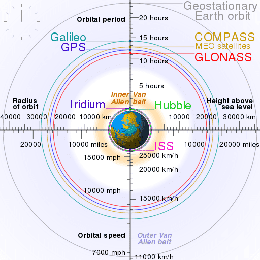

Thanks. Didn't realize how low the ISS orbited.

What I'm saying is that a satellite could stay in a lower orbital if it had an ion stabilizer that constantly pushed it up to counteract the effect of air drag.
