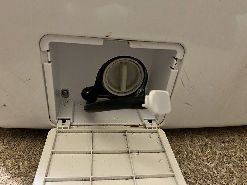

russ_watters said:
I have a pretty much brand-new washer, and the manual doesn't say anything about a filter - and I've never seen one before on other washers. Can I ask someone who has a washer with a filter to show it to me? This honestly makes no sense to me.
Here is what mine looks like:
Open service panel on the front of a white washing machine showing a round drain pump filter cap, a black drain hose with a white plug, and a white hinged cover with a grid pattern.
The tube with the plug is drain out water before taking the filter out.
Thanks. The reason this makes no sense to me is that I just figured since I'd never seen one before that pump makers had figured out how to make clog-free pumps 50 years ago, and the drain line is clearly designed to handle solid waste. But evidently there's something different about front-load washers that seems to necessitate strainers.
