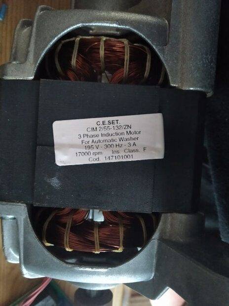

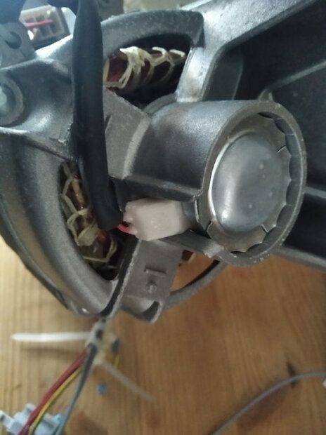

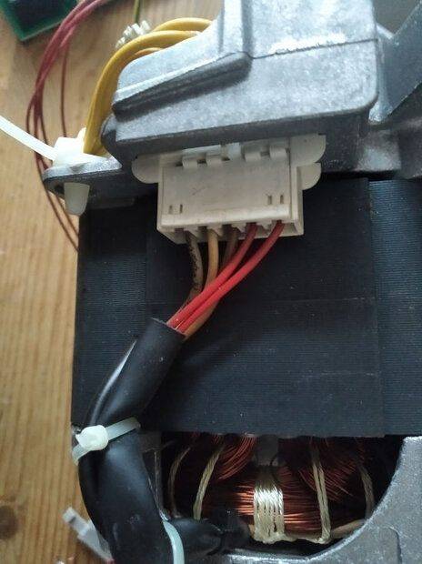

Here are pictures of the washing machine motor:
Washing machine motor with a black laminated stator core, a label reading 81040544, CIM 2/55-132/ZN7, Line A30, WK 24/07 and a barcode, mounted on a grey cast housing.

Close-up photo of a washing machine motor with a white plastic multi-pin connector, red and yellow wires, a cable tie, and exposed copper motor windings below.
Close-up photo of a washing machine motor with its stator windings visible, a black cable entering the housing, and a white plastic terminal connector with red wiring.

The photo you posted of the washing machine motor states 300Hz on the name plate.
Your power and the well motor are 60Hz.
Conclusion: the two are not compatible!
