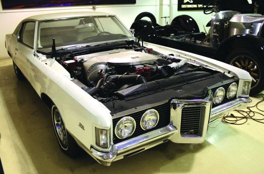

AFAIK, the last time steam cars were seriously considered was by GM in the late sixties. Jay Leno has an experimental 1969 Pontiac Gran Prix, steam-powered.
https://www.hemmings.com/blog/article/full-steam-ahead/ said:
1969 PONTIAC GRAND PRIX
A steam-powered, four-cylinder 1969 Pontiac Grand Prix? It’s true: GM engineers were so sweating California emissions legislation in the late 1960s that they went to extraordinary lengths–including building a steam-powered Grand Prix for evaluation. The in-house-developed GM SE-101 used a 160hp, four-cylinder expander, and let technicians evaluate a steam engine under actual operating conditions.
“It’s similar to the Doble in principle,” Jay tells us. “It burns all of the fuel, so emissions are low, but you need to carry oil, water and gas. It’s the only functioning steam car with power steering and brakes. They had to stretch the nose nine inches to accommodate the engine. It worked, but fuel consumption is too high.” Not helping: an extra 450 pounds over the front wheels, with an engine putting out half the power. “Modernizing steam is a bit like working on the best Betamax video recorder… you know, technology has moved on, so why go back?” GM clearly agreed, and the experiment was stillborn.
