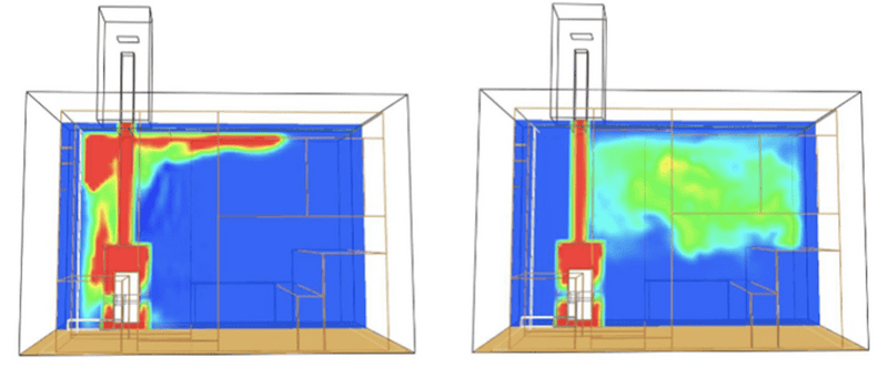

Same temp & pressure but very different feeling.
The steam in some saunas feels much harsher, hotter, burning or 'biting' than in other saunas. The sauna temp is the same at 90°c, pressure is the same or very similar. The amount and temp of water used is the same or similar.
The only obvious difference is that the with the harsher feeling steam some or all of the steam is created from water on steel while in the more comfortable or gentle saunas it is created almost exclusively from water on stones.
I assume the temp of the steam itself is the same, ≈100°c, given the same atmospheric pressure?
Could it be that the steel produces steam much faster than the stones to there's a more sudden or quick burst of steam than with that created by stones?
Other?

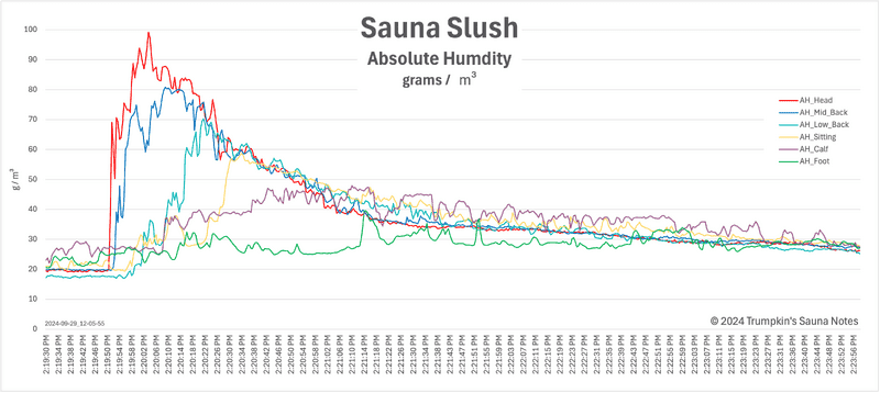

Here's a chart of steam creation from stones:

The line chart in the first post shows humidity over time as it descends down from the ceiling.
Ok, thanks - do you have one for the steel?

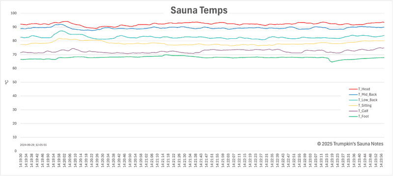

So… Sauna is 90°c at head height (10cm below ceiling), 72°c at feet and 38°c at the floor. Absolute humidity at all strata is ≈ 25g/m³ (or approx 3-8% RH) - E.G., the brief bit in the line chart above before throwing water on the stones.
I throw a ladle of water on the 200°c stones. The water becomes 'hot water vapor?' that rises from the stones to the ceiling, flows across the ceiling (away from the pressure of the rising plume) to the far walls and then begins to descend on to bathers. Bathers feel an intense increase in heat.
The air temperatures have not changed, they remain constant at all strata. The humidity increases per the line chart above. There is no noticeably visible water vapor anywhere in the sauna (nor will there be in most cases).
The vapor immediately above the stones is steam? Superheated steam? Saturated steam?
What is the invisible water vapor that descends on bathers and causes a feeling of an intense increase in heat (even though ambient air temps have not increased)?
And that in some cases can be an unbearable increase in the amount of heat felt.

Here are air temps for the same period as the humidity above:
