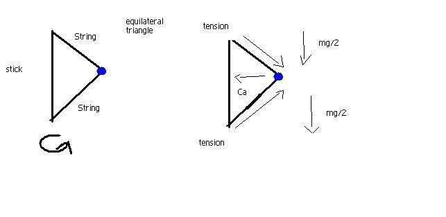

Hi,
please see the drawing I ' m not good with words.
If both string have the same lenght, will they have the same tension ?
I guess the answer is yes, they share the same centripetal acceleration, and they have the same lenght. The tension will be the same because they share too the force ( mg).
Its strange because when the stick don't turn only the upper string hold the weight.
  • Hand-drawn diagram of an equilateral triangle with a stick on the left side and a blue ball at the right corner, held by two strings labelled String. Right panel shows tension arrows along both strings, centripetal acceleration labelled Ca pointing left, and two downward arrows labelled mg/2.
Don't guess: Figure it out. Label the forces acting on the bead and apply Newton's 2nd law.

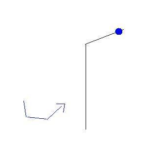

believe me I want to figure it out
Want i don't know is that it is or not possible that the ball on a one string system goes higher that the stick.

Is the ball going in circular motion around stick? ... or something else?
Is this a different problem? What about the first problem?
Sorry,
I took some time off to have a fresh start.
I don't think that both string have the same tension since one have to support the mass of the ball.
We know the verticals forces have to be equal since it make a equilateral triangle.
The ball is at 60 degree
So
T=tension upper string
t= tension lower string
Tcos(60)-mgcos(60)= tcos(60) cos(60)=0.5
T=(t/2+mgcos(60))/0.5
By this equation we know that the upper string tension will be more than the lower string tension.
thank you
The vertical component of the net force must equal zero since there's no vertical acceleration.
So
The weight is already vertical, so there's no cosine factor needed in that term.
Otherwise, OK!
To actually solve for the tensions, you'll need to consider the horizontal components.
To have the ball go higher than the tether point, either the ball or the string would need to possesses airfoil properties and generate lift!
