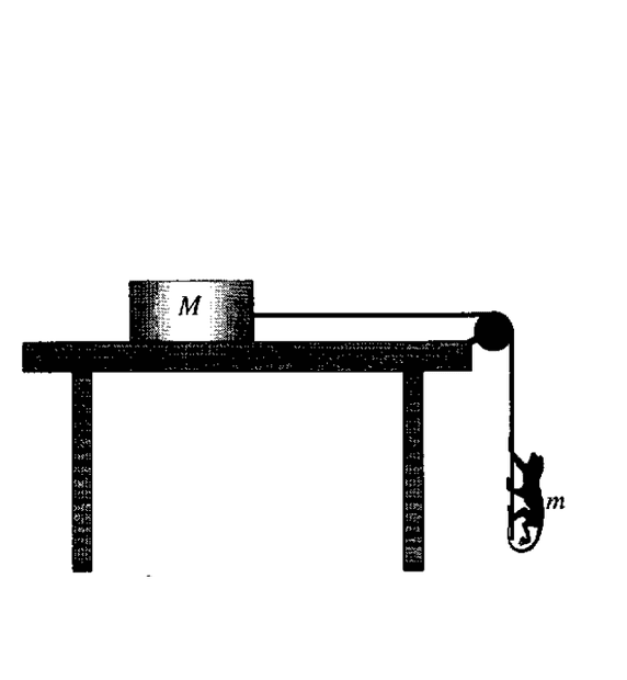

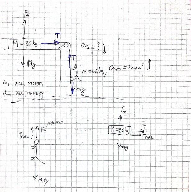

Find the acceleration of the system if monkey a) is at rest, b) is moving upwards with 2m/s^2 relative to the rope, c) is moving downwards with 2m/s^2 relative to the rope
F=ma
Body M has a mass of 80kg and monkey has a mass of 20kg. No friction between table and the object M.
Can someone please explain to me if the acceleration of the system will be greater with monkey accelerating up or down(relative to the rope), and why. Monkey accelerates both up and down at 2m/s^2(relative to the rope).
Like, I know that if monkey pulls the rope to go up, he will cause tension of the pull plus the tension of himself on the rope and therefore acceleration of body M. So it must be that accelerating upward causes greater acceleration then accelerating downward.
But in my textbook the answer is different. Apparently monkey causes greater tension by accelerating down(relative to the rope), and I don't see how is that possible. I know that F=ma so if he accelerates 2m/s^2 down +g(10m/s^2) that is 12m/s^2, multiplied by m, we get greater Fnet, and therefore greater acceleration of the system).
I just can't understand how is he able to accelerate down the rope, if he was pulling the rope with his paws, he would just push the rope behind him, and in my mind that would only cause less tension instead of more. Unless the rope is really long and heavy so that he can't push it behind. Then okay I guess it's possible.
But shouldn't monkey's pull on the rope when going up cause greater acceleration of the body M and therefore greater acceleration of the system?Also, apparently monkey doing nothing(not accelerating up) causes greater acceleration of the system then monkey accelerating up. This bothers me because I have watched the video of the guy explaining how monkey can lift the crate of the ground connected with a rope over the pulley if he accelerates up the rope with acceleration that is big enough. There are few videos on internet similar to this one but I don't understand what are they saying. I tried following abbreviations for the forces but I get lost eventually.
Here is the photo of the sketch.
Thank you.
Note that the monkey's acceleration is relative to the rope, not relative to the table.
Draw a free body diagram of the monkey.
Then draw a free body diagram of the rope and mass ##M##.
Post them.
I assume that by acceleration of the system you mean the acceleration of mass ##M##. Correct?

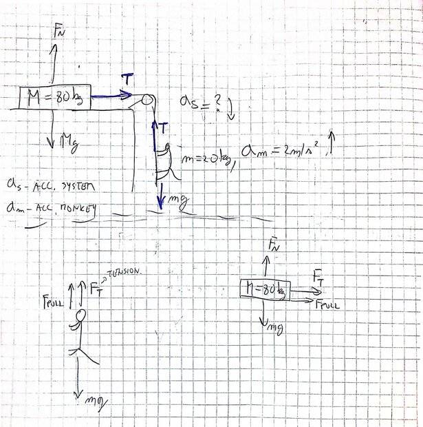

Forces acting on the monkey are Tension(Ft), gravity(mg) and upwards pulling force(Fp).

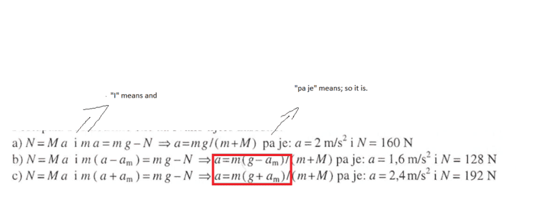

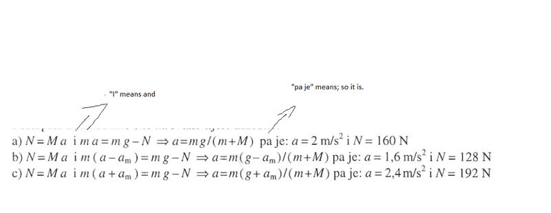

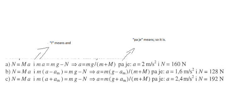

and here is the screenshot from my textbook solutions.
a) asks about when monkey is not moving, so it's irrelevant.
Iamconfused123 said:
In b and c there are sign errors in the algebraic manipulation. See if you can spot them.
In your FBD of the monkey, you have ##F_{pull}## and ##F_T## acting on the monkey. Its either or depending on what you take as the free body but not both.
I see, they swapped the signs. I could never see that. Thank you very much.
Isn't it both? I tried to think about and I am probably wrong but in my mind the tension is keeping monkey from accelerating at 10m/s^2 and instead accelerates with 2 m/s^2 while the pull causes it to not accelerate at all(also with tension applied), because monkey has acceleration o 2m/s^2 upwards relative to the rope while rope is falling at 2m/s^2.
You show ##F_{pull}+F_T## acting on both M and m. How is this happening? There is only the rope under tension to transfer force between the two.
Whatever force the monkey exerts on the rope is necessarily the tension in it.

I don't know. I got something wrong then. I mean I get that the pull will act as tension force. I don't know why I draw that separately, but even worse, I thought that monkey was staying in place while climbing up. Because when monkey is not moving the system accelerates at 2m/s^2 and now that monkey is accelerating 2m/s^2 upwards I thought that he stays in place on y-axis.
How can I calculate with what acceleration will monkey have to move up to stay in one place on y-axis. I suppose that there is no one acceleration value, because when he starts to accelerate up, the body M will accelerate even faster down, so monkey will have to increase the acceleration in order to keep up, am I correct?
What are the forces on the monkey? If it is staying put in the ground frame, what can you say about those forces?

I don't know what do you mean by ground frame, but overall, the only forces acting on the monkey are tension(upwards) and weight(downwards). If by ground frame you mean monkey relative to the ground then yeah, tension and weight. But if the monkey accelerates upwards the tension force increases and the rope starts falling down faster, and that happens in exact moment when monkey starts to accelerate, so it's like a vicious cycle. Right?
The constraint is that the rope accelerates with the same magnitude as block M.

The ground frame is the inertial frame of reference of the Earth's surface, in which Newton's laws of motion apply.
Right.

I asked about the case where the monkey is staying at the same height. What is the monkey’s acceleration in the ground frame? What does that say about the two forces? Remember, ##F_{net}=ma##.

Well, Tension and weight are equal then. Acceleration is 0

So you know the tension for this case. What does that give for the acceleration of M?

Then a=T/M = 200N/80kg = 2.5m/s^2.
But in case b) in original problem, we had acceleration of 2.4 and tension of 240N for that acceleration. So that means we can't have 2.5 m/s^2 acceleration with 200N tension force, because that is force when monkey is standing still on the rope(a=0 m/s^2), if we take that monkey is accelerating up that creates additional tension. And then we have to go back and adjust the a=T/M, and it's vicious cycle.
So then it's either impossible for monkey to stand still in the air(on the rope) with one acceleration value or monkey really doesn't create additional tension by accelerating upwards.

It's not a vicious cycle. It's called a variable. And it's what mathematics and Newton's laws are designed to resolve. Where your raw intuition is insufficient.

It's not impossible if you use mathematics with variable or unknown quantities in your equations.

How do you get that tension?
Remember that the sign errors in the snippet pasted in post #9 had the effect of swapping over the answers for b and c.
