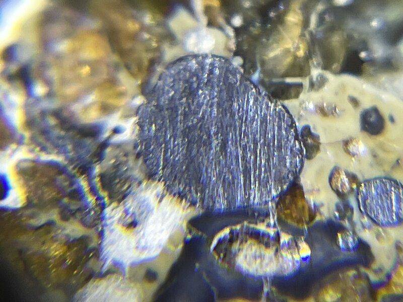

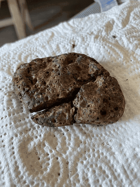

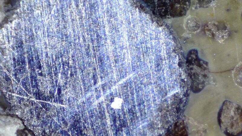

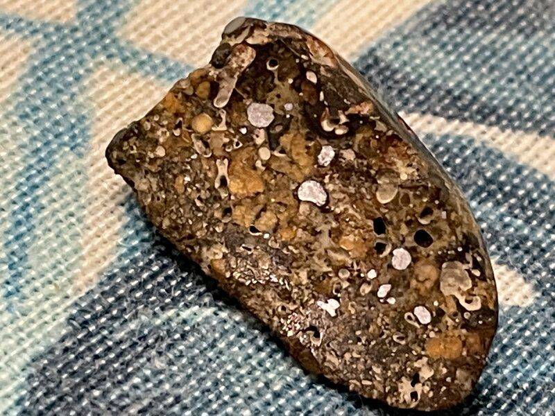

Aidan
Hello! My friend found a rock on a beach near Ancona, in central Italy, and now he's convinced it's a meteorite. I have some doubts, however: it looks too cracky and porous. I'm attaching a few pictures of the rock: could someone give me an opinion?
Thank you very much for the kind attention,
Stefania

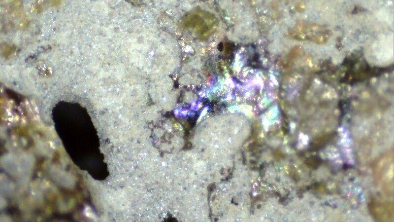

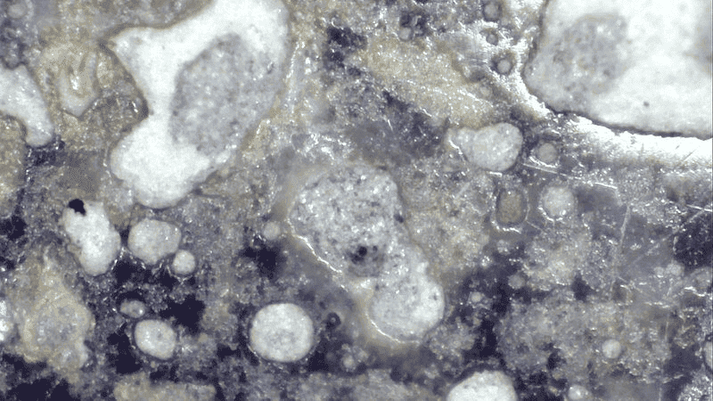

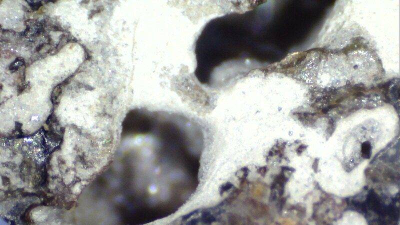

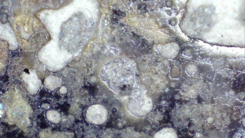

I actually have more detailed images of the inner surface of the rock, because, as you can see, it craked in different fragments.

1. It could be a local coarse grained sedimentary rock, rounded in a stream or on the beach. The small stones that make up the rock were rounded during the original deposition. The layering of grain size suggests a river deposit with some flood events depositing the biggest grains.
2. Maybe a rock from a volcanic cone, stratified and then weathered. Ignimbrite? But that is not where I would expect a local volcano. How far from Vesuvius?
3. It is deeply weathered and appears to have iron oxide staining. Maybe it is waste from an iron refinery, that was dumped to make a sea wall.
4. It might be a ship's ballast, dumped before an empty ship was loaded in the local port. It could have come from any port on the Mediterranean, over the last 3000 years.
5. I think meteorite is unlikely because of the stratification and the rounded grains.
Did you look for other similar rocks nearby on the beach ?
Was the area glaciated in the last ice age ?
Does it contain metal ?
Is it magnetic ?

hi you Stefania
OK first up, I don't see any evidence of any of them being a meteorite
OK let's look at each in turn :)
1) this one looks very volcanic in origin ... vesicles ( gas bubble holes) are a dead giveaway that it isn't a meteorite
2) tho this appears to have objects that are similar to chondrules - I would like to see a closer look
I suspect they may be crystal vugs and again the sample appears to have vesicles
3) No, definitely not. This sample appears to be full of quartz or other white minerals
you would never see a meteorite looking so white like that
4) I have no idea of the scale of this image, tho it appears to be well magnified
It also doe
snt have the looks of a meteorite
