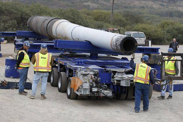

Just one 16" naval gun weighs more than 100 long tons (100,000 kg) and is approximately 20 meters long. This photo gives an indication of how massive one of these guns is:
Project HARP used two of these monsters in tandem. Should you even get such a massive assembly aloft, firing it from an aircraft would be interesting, to say the least.

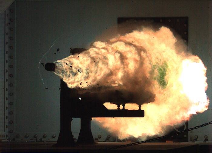

Recently, the US Navy has been performing trials on a prototype electromagnetic rail gun:
http://en.wikipedia.org/wiki/Railgun
The test gun has been shown to throw a projectile at a velocity of 2400 m/s. Eventually, the Navy hopes to develop a gun capable of accelerating a projectile to 7000 m/s.
At the equator, the Earth's rotational speed is about 465 m/s. Orbital speed at the same location is 7900 m/s relative to a fixed reference. A rail gun capable of orbiting a payload would need to be capable of imparting a Δv of about 7500 m/s, in round numbers.
http://en.wikipedia.org/wiki/Orbital_speed
Here is a pic of the USN rail gun test:
The flames are from the atmospheric heating taking place after the projectile has reached a velocity of 2400 m/s​
