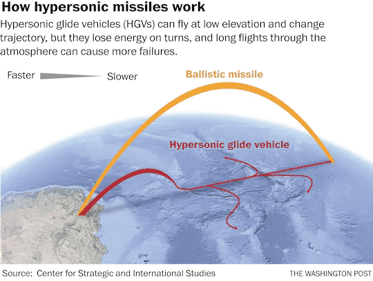

Washington Post prints this article on Russia's hypersonic missile use in Ukraine with diagrams among other weapons. This non-technical article contains discrepancies such as sea vs. air launch.
https://www.washingtonpost.com/world/2022/03/23/russia-ukraine-weapons-missiles-nukes-drones/
Russia’s weapon is named Kinzhal — Russian for “dagger.” A modified version of Russia’s ground-launched Iskander missile, it is an air-launched ballistic missile that can be maneuvered to hit a target or dodge defenses. Russian officials say the missile was used last week to hit an ammunition depot in western Ukraine.
On Wednesday, Russia said it had also used a long-range cruise missile called Kalibr in an attack on Ukrainian forces earlier in the week. The missile, which can be launched from sea, was first used by Russian forces in Syria. U.S. officials said they could not confirm that the weapon had been used.
