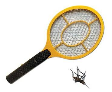

Hello.
I'm an English language teacher researching the details of a class project; I use projects to develop language skills.
I have a background in mechanical engineering but know little to nothing of electrical engineering, hence this post.
Questions for members of this forum:
Electrical tennis racquet bug zappers... Do they discharge if they are not arcing?
1. If the operating switch is held down and no bugs cause an arc, will the battery of the device discharge at all? Put another way, if we tape the switch in the 'on' position but zap no mosquitoes, will we need to recharge the battery anytime soon?
2. Arcs from the tennis racquet that we have give an RF signal at around 3.8MHZ. This signal covers a distance of around 4 metres; zap a bug and hear a corresponding 'click' on your nearby shortwave radio.
Is it possible to build a simple device that can count the clicks?
Could anyone give directions to an instructional source or learning resource that would help us build such a device?
Many thanks for your help.
Rob
They contain a circuit that steps up the battery voltage to a much higher value (2000V according to some web references). That circuit isn't 100% efficient, it uses power even when there is no output power (no arcing). So yes the battery will discharge when the button is held down and there is no arcing. Even when there is no arcing there might be some current leaking between the electrodes. Due to the voltage step up any small leakage current implies a much larger battery current. Many also have an LED on them.
In many countries buildings a spark transmitter/receiver set up could be illegal. Although enforcement might be unlikely unless you cause problems for other radio operators.
Yes it would be possible to design a circuit that plugged into the headphone socket of the shortwave radio and counted the clicks by I'm afraid I haven't time to design one for you. Basically it would probably need to rectify the sound and do peak detection, convert to digital, feed into a computer/counter/Raspberry Pi?
It should be possible to measure the battery current and estimate battery life that way.
The arc discharge radiates energy at about 3.8 MHz. But the click is an audio envelope at audio frequencies. There may be several close pulses associated with one arc.
You will need to detect and rectify the click, then low-pass filter the detected envelope. That might be done with a crystal set, using the coil as the antenna. When first detected, add one to the count, then wait until the signal is gone, hold off for a set time to make sure the discharge has ended, then re-arm the detector and counter.
1. What is the maximum rate of clicks per second, or minute, that you need to count ?
2. How will you display the count ?
3. Have you considered building the counter onto the racquet ?
You could then avoid the radio link and detect the discharge internally, using the internal power supply for the counter and display.

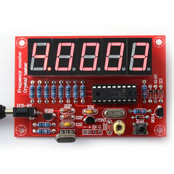

Have you done any Arduino or other microcontroller (uC) projects in your class yet? If so, it's straightforward to take the audio output of the shortwave receiver and put it into an analog input (or even a digital input) of the uC and write a small program to count the clicks.
If not, you should be able to find a small electronics project kit to do the counting. I'll do a quick Google search...
EDIT/ADD -- From a Google Images search:
https://www.google.com/search?q=ele...irzXAhVhxFQKHf0LBA0Q_AUICygC&biw=1241&bih=791
10PCS-LOT-font-b-DIY-b-font-Kits-RF-1Hz-50MHz-Crystal-Oscillator-Frequency-Counter-Meter.jpg
  • 10PCS-LOT-font-b-DIY-b-font-Kits-RF-1Hz-50MHz-Crystal-Oscillator-Frequency-Counter-Meter.jpg

Could I buy a frequency counter off-the-shelf that would work at the required frequency, or would I need to tune one or set one up?
Do you know of a forum, website, Facebook group, or otherwise that I could go to to find instructions on how to set up and use a frequency counter? I can hit Google for it, no worries, but if you know of a good one, that would help.

Ok, frequency counter sourced:
https://play.google.com/store/apps/details?id=com.keuwl.audiofrequencycounter&hl=en
initial settings - these give a single count for our audio signal > threshold level at minimum; noise level at maximum, gate time 1 second, measure = freq, direction = rise, coupling = DC, gain x2, time div = 320ms
The count from these settings is yet to be properly observed and confirmed, but they give a working start point.
I don't think a frequency counter will do the job you need done. You need to condition the detected pulses in the burst due to one insect and hold-off before the next. You need to count those insect encounters, without forgetting the count every second.
