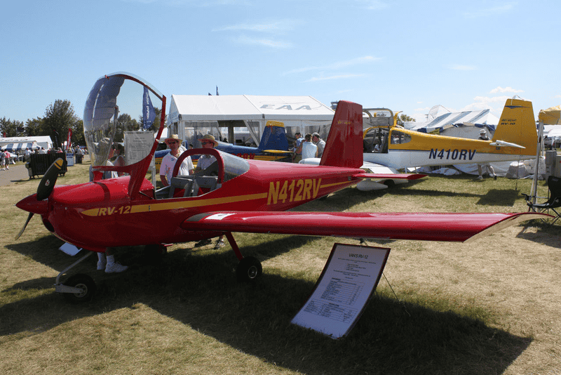

Prototype RV-12 pictured below.

Flyboy said:
2. The frame you see there is where that bubble cockpit opens up, tipping forwards. The helmet he’s wearing is just being cautious in a confined cockpit. I would probably wear one too in that plane… I don’t want to smack my head on the canopy when it gets bumpy!
Sorry, I'm not buying it. His whole figure (shirt, helmet, etc.) is in *front* of the near side cockpit support. I call Photoshop...
I’m not understanding where the problem is. That frame is behind the pilot by design. Take a look at the picture of the prototype.
Unless you mean he is closer to the camera than the frame, which I would argue is probably optical illusion.
I haven’t seen this exact airplane before, but I have seen an RV-12 and it looks pretty normal.
