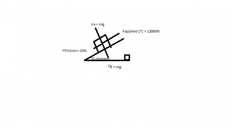

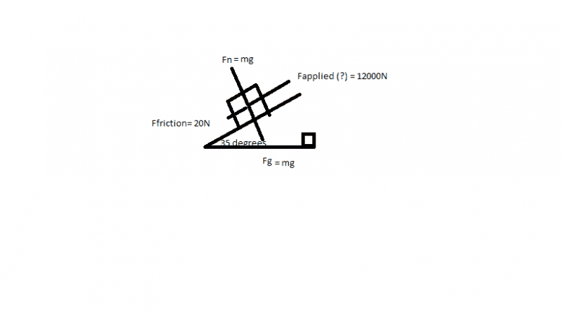

Yes, but it is probably incorrect. I haven't gotten much of a handle on the angular free body diagrams.

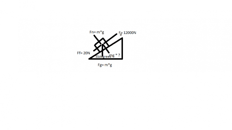

Sorry, gravity should not be at an angle.

Would I be closer with this one?
Pretty close. The forces appear to be pointing in the right directions now.
The force of friction is kind of strange in this problem. It's the friction between the road and the car which propels the car forward, just like the friction between the soles of your shoes and the ground allow you to walk forward. In one part of the problem, you're told this force is 12000 N, and then you're told there's another force of friction which is 20 N. (Maybe it's air resistance or something like that.) So let's just assume it's slowing the car down. If we do that, the way you drew it on the free-body diagram is correct.
Typically, what you do with inclined-plane problems is you orient the axes so that one is parallel to the plane and the other is perpendicular. This makes the math simpler. If you do that, only the weight doesn't lie in a direction parallel to the axes. So that's the only one you need to resolve into components. That's what you want to do next.
I understand it now! So the net force would be 12000N- m*g*sin(35) - 20N (frictional force). From there, we divide by mass to get the acceleration and the find the final velocity which in turn would be the launch velocity. Then I can use the Range= vi^2 /g * sin 2 theta to find the distance and divide by 8 to get the number of helicopter blades.
