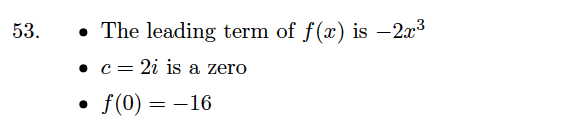

Hello!
I understand that this is a very simple thing, but somehow I can't find the key :)
Please, take a look a pictures attached with a problem and an answer. The task is to create a polynomial f with real number coefficients which has all of the desired characteristics.
I can't figure out how we got factor x+2.
if f(o) = -16, it means that according to the Remainder Theorem the remainder from the division by (x - 0) of polynomial f should equal - 16. Well, dividing by (x-0) means dividing by x. Hence, I thought that factoring should be of the form
-2x (x - 2i) (x + 2i)
How did they arrive at x+2?
Thank you!

If you assume the third factor is of the form (a*x + b), then what must a and b equal in order to satisfy the conditions that f(0) = -16 and that the leading term of the polynomial is -2x3 ?
Note: the third factor is (x + 2) only if a = 1 and b = 2.

I don't think this is right. You might want to revisit what the Remainder Theorem says.
If f(0) = -16, and you divide the function by (x-0), you are dividing by 0 at x=0. Essentially imposing the idea that 0*g(x) = -16. That can't be right.
If you know that f(0) = -16 and the leading term has a coefficient of -2, you should be able to say that the factor has the form (-2x +a)(x+b)(x+c) with abc = -16, or as in the answer you posted -2(x+a)(x+b)(x+c) where abc = 8. Since when x=0, the only remaining term in the expanded polynomial is abc.
