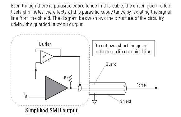

So I looked up the driven guard here:
http://www.keysight.com/upload/cmc_upload/All/2-Parametric_Measurement_Basic.pdf?&cc=US&lc=eng
and I see that it reduces effective parasitic capacitance in a triaxial cable by isolating the signal line from the shield.
This would seem not very effective in my setup since what I need is actually an object whose self-capacitance is in the zF range. Perhaps this is only possible with nanotechnology; I was just hoping maybe there were some ingenious physics trick by which I could generate an "effective" zF self-capacitance without actually making the physical size so small, maybe by using an extremely low-density conductor like conductive foam or something (trying to find info on that now).
Yes, point being it surrounds the signal cable with a shielding conductor(think Faraday cage) held at same potential
so there's no incentive for current to flow through the capacitance between those two conductors.
