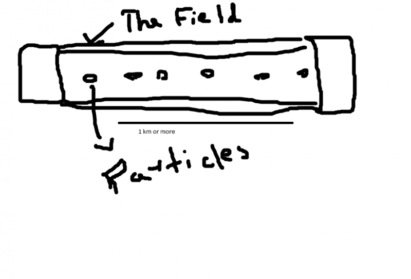

how could i make a linear electromagnetic field to a great distance
What exactly do you mean with "linear"?
Make a large, strong source. The question is way to broad for a more specific answer.
A Electro magnetic field that is in a straight line that could go to a great distance
Are you talking about something like a laser?
"A electromagnetic field" is extremely vague. You're going to need to be more specific if you want help.
something like this.that could work in open air
No, nothing like that can be built to create an electric or magnetic field that doesn't fall off in strength over such a large distance in the open air. You'd need a large tunnel filled with electromagnets in order to generate a 1 km long magnetic field, and I'm not sure it's even possible to do something similar with an electric field.
A linear electromagnetic field might be interpreted as one that did not fall off with distance. When radiated through space from a point source, the field will fall off as the inverse square of the distance. By confining the EM field to a waveguide, a 'linear' field can be achieved. A waveguide is simply a long skinny cavity bounded by metal.

something like this.that could work in open airView attachment 73793
To get a field that is not completely different from your sketch, you would need objects significantly larger than 100m on both sides (~500m is better). It is possible, but you would have to construct something like multiple large towers.
