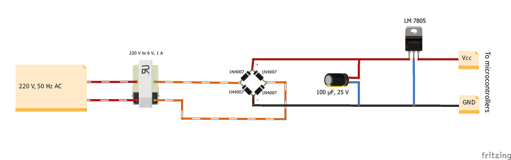

I am using the 7805 for this project. I just said that I will "note" it down, and might explore it in my future projects.
This is the final circuit for this project, with the corrections that you suggested:

I would never persuade someone to use a switcher who has lacks experience as the OP in this thread does. Please @Wrichik Basu don't think I am belittling you in that comment. Nothing wrong with being inexperienced. After all, we were all inexperienced at one time (some of us still are in areas) and you are here asking questions and making headway.

Different regulators need different input and output capacitors to maintain stability. A ceramic capacitor across the input will hide the connection inductance and resistance of the electrolytic reservoir capacitor from the regulator. A ceramic capacitor across the output hides the output wire inductance, so stability is not dependent on changes in the load.
I therefore suggest that you place a 100nF ceramic capacitor close to the 7805 input, and another close to the output.

Along with the electrolytic capacitor?

Yes. One ceramic capacitor is electrically in parallel with the electrolytic, but it is placed physically close to the regulator.

This is the new final diagram, then:

If you want to max it out then a fuse on the mains side. Not really against overcurrent - more against transformer failure. So it depends on the type of the transformer, some does not require additional fuse.

Safety precautions on the mains side are already present. I bought a custom-built extension board from Amazon that has a fuse built-in. Originally it was 6 A; I replaced it with 1 A. This is hidden under "220 V 50 Hz AC" in the diagram.

Wrichik Basu said:
I need to create a 5 V stable DC supply out of 6 V AC from a transformer. By "stable", I mean that I do not want the ripples in the voltage that one gets from the output of a full-wave bridge rectifier. I have to feed this to two ATmega 8A μCs.
I am going to create the following circuit:
6 V RMS means ≈ 8.5 V peak. The capacitor will hopefully smooth out the ripples. The LM 7805 voltage regulator will bring down the voltage to 5 V. I can attach a heat sink to it if it tends to get heated up too much.
I don't yet have all the materials; once I get them, I can use the Arduino analogRead() function to have a look at the waveform of the output of the circuit because I don't have an oscilloscope.
Does this circuit look okay? Any suggestion for improvement?
You need another 100uf capacitor on the output to reduce ripple, I would use 330uf or 500uf on the output. If you have no scope test it with a digital meter. If meter reads 5VDC and 0VAC your good. If meter shows .01VAC you still have a tiny amount of ripple. If meter reads any amount on AC it means you need a larger output cap. I use 7805 in some of my circuits I think it needs a voltage difference of 1.5v to work. I bought a hand held $25 scope from china it works great. You should be ok, 6VAC x 1.414 = 8.484 volts peak to peak. Put a heat sink on the 7805.
  • #50
Any time you need 100uF on the output of a 7805 drawing minimal current, something is seriously wrong. You can't lose going by the data sheet on capacitor recommendations. I've never seen a 7805 data sheet specifying 100 uF on the output.

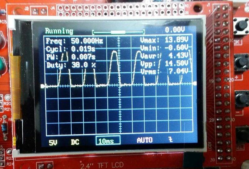

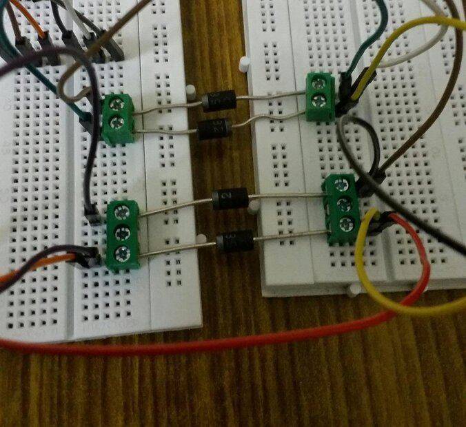

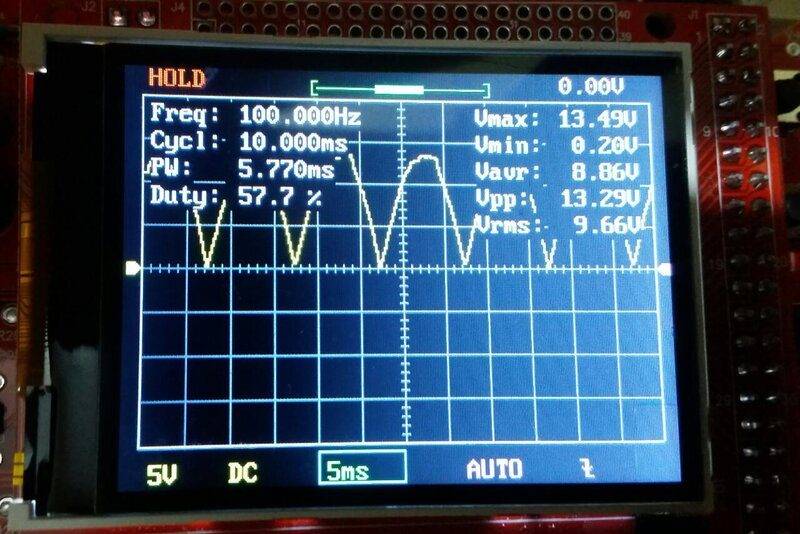

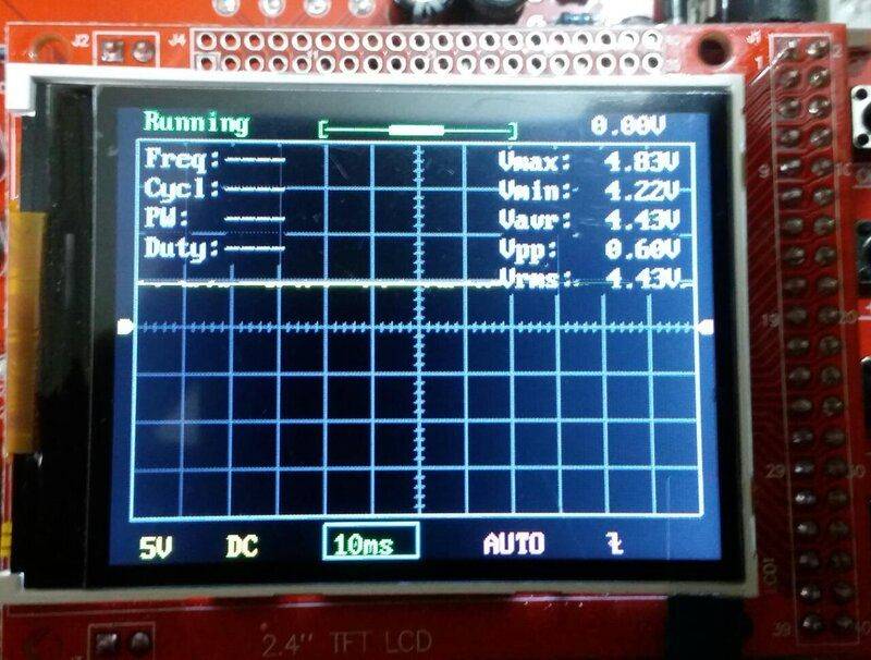

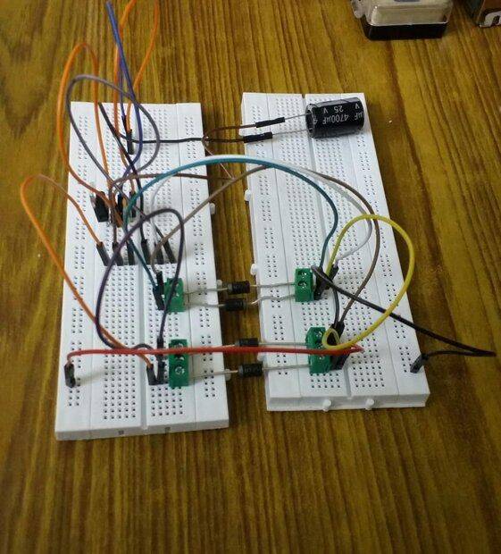

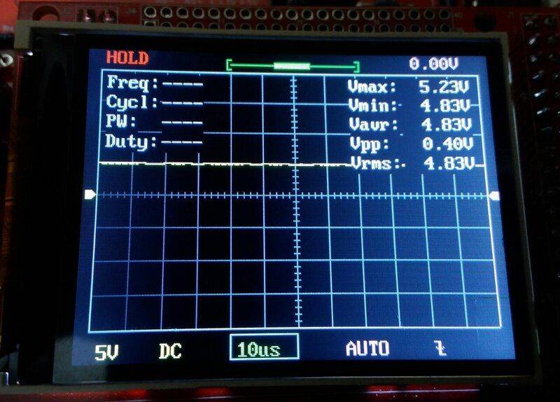

After a really long wait, I could finally gather all the required components (including the oscilloscope proposed earlier). But trying to put the Schottky diodes into a breadboard drained away my enthusiasm. Man, I just couldn't push them in — the leads were so thick! Even the large capacitor was creating trouble: the positive lead was so long, that when I pushed it in, the shorter negative lead couldn't be pushed in. Finally, made a compromise:
That diode got bent when I was trying to put it into the breadboard. Probably one of the ugliest circuits I have ever built.
Will test it tomorrow morning, after rechecking the diode bridge connections.

Be careful about forcing fat leads into the breadboard, you can stretch the springs and cause connection problems later with really thin leads.
Honestly, I hate those things and will only use them for something I know for sure I won't be using tomorrow. OTOH, most everyone else doesn't agree with me!
95% of my breadboards look more like this:
  • #60
With experience, you can directly solder components. But I don't have that, and have to depend on breadboards.
