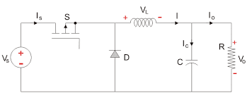

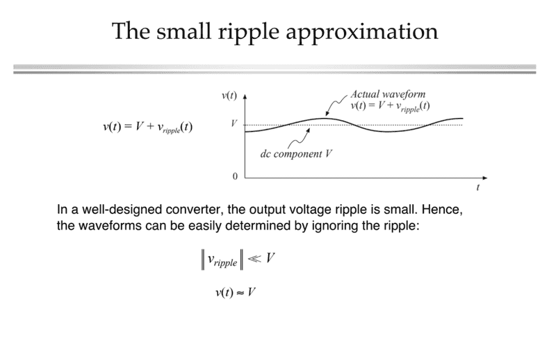

I am reading a book 'Fundamentals of Power Electronics' - Erickson. The book begins with a buck converter and the assumptions that we use so that we do not have to deal with 2nd order equations. I will first explain what the book says
What the book says?
The book says that the LC filter of a buck conveter should be designed so that the cut-off is lower than the switching frequency of the converter. This is to remove any ripples at the switching frequency or its harmonics. Of course, you cannot fully eliminate them, you can only attenuate with the LC filter, so there will be a small ripple. The small ripple approximation assumes that the output of the LC filter (= output of buck converter) is just the DC output voltage and that we can neglect these ripples. Ok, makes sense. Let's move on.
The book now draws the inductor current waveform. It provides an equation for the inductor ripple current. The DC portion of this current goes to the resistive load, thereby generating a fixed output voltage. The AC portion goes to the output capacitor.
Why am I confused?
The AC portion that goes to output capacitor will cause the output capacitor voltage to increase. The output capacitor voltage IS the output voltage of the converter, hence there will be a ripple on the output voltage due to the AC current of the inductor flowing into the cap. This contradicts the small-ripple approximation we made at the start, that the output voltage is fixed.
I am very confused. We started with an assumption that the output voltage is fixed, we used that assumption to get the equation for the inductor current. The AC part of this current flows to the cap, which creates an AC ripple on the output. This is a contradiction.

Yes, but it is small and can be approximated as DC.
Why? It wasn't a zero ripple approximation. You can think of this as a sort of successive approximation process. After you model it as DC it may be good to verify that that was a "good enough" approximation.

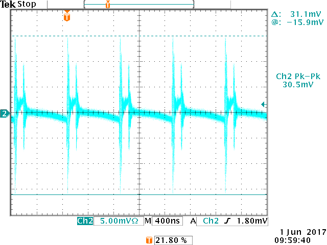

Yes, there is a sort of sinusoidal ripple voltage due solely to the capacitance at the switching frequency. But in practice every time the cap current changes polarity, at the min and max cap voltage, the ESR causes a quick step which is often larger than the capacitor ripple.
In this photo (which I stole at random from the web) you will see three main features of the SMPS output ripple & noise.
- The high frequency spikes are created by the switching and parasitic stuff, what @Averagesupernova referred to. Device selection, PCB layout, and snubber design are a huge issue with these.
- The rising and falling slopes are from the LC filter showing a bit of the fundamental (switching) frequency getting through the filter.
- The step like feature between the rising and falling capacitor voltage is due to the cap ESR. It is because the cap current switches direction, sometimes that Ic⋅ESR voltage adds to the output, other times it subtracts.
PS: Notice the scale at 5mV/div for a 3.3V PS that is 0.15%/div, which is why we start the analysis by pretending it's zero.
