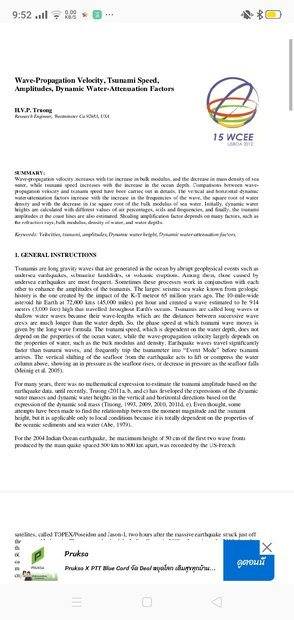

The confusion I have with the tsunami traveling at 800 km/hr(my data above)is that implies that the wave crest is moving across the sea surface at 800km/hr. But this is not the case. In linked paper here author states it is the energy propagation traveling 800km/hr and the crest velocity much lower. See 4
@morrobay
Sorry but the resolution on your scan is just not good enough to read. Can you they it with 300dpi please?

The paper does not attach. So just search: Wave Propagation, Tsunami Speed... By Truong. Then see 4. Thanks
sophiecentaur said:
Thanks.
Which part are you having a problem with? Is it the apparent paradox that the 'slow disturbance' propagates very fast? (as in the sentence
"This phase velocity is the velocity of energy propagation, not the velocity of the water itself.")

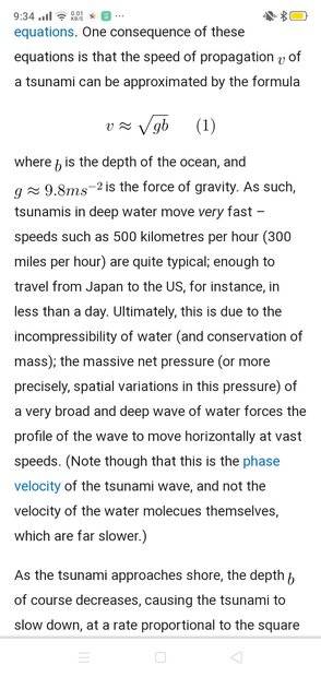

Thanks I just woke up 0600. Yes that is the question. So as in post #4 above then the crest velocity does not equal wavelength/T and w/k. Vph = sqrt g(D+A) is required for energy propagation that is independent of wave period.

This screenshot explains tsunami propagation.
