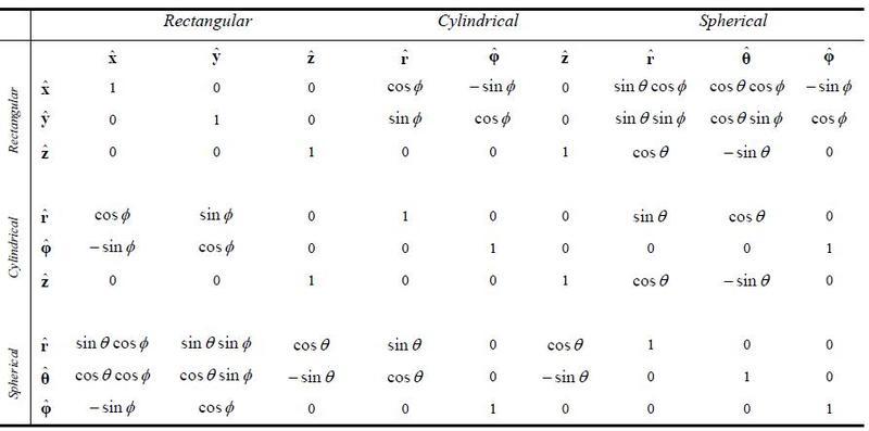

I have a nice table that shows the dot product between unit vectos (see annex). I'd like know how is the cross product between unit vectos of all basis. Do you have a table with such information?
  • Table of dot products between unit vectors in rectangular, cylindrical and spherical coordinate systems, with rows and columns labelled by the unit vectors and entries such as cos φ, sin θ cos φ and cos θ.

Not that I can think of. You should probably be able to calculate the cross product in Cartesian coordinates, and then convert to spherical or cylindrical coordinates.
