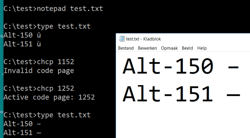

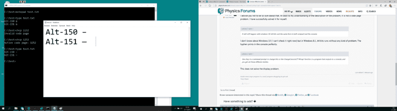

No?
Screenshot of a Windows Command Prompt session running type test.txt, showing Alt-150 and Alt-151 lines with mismatched dash characters, beside a Notepad window displaying the same file with dash characters.
  • Screenshot of a Windows Command Prompt session with a Notepad window open on top, showing the commands chcp 1252 and type test.txt and the output Alt-150 – and Alt-151 –.
No?
In a similar situation for me this didn't work. I hope that I'm clear enough. I could upload snapshots as well but let the OP say which one solves his problem.
