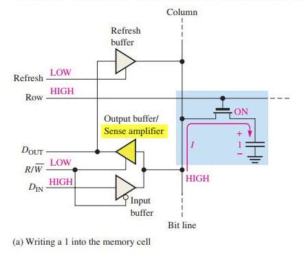

Please have a look on this attachment. The following text is from the parts highlighted in yellow in attachment.
"Dynamic memory cells store a data bit in a small capacitor rather than in a latch. The advantage of this type of cell is that it is very simple, thus allowing very large memory arrays to be constructed on a chip at a lower cost per bit. The disadvantage is that the storage capacitor cannot hold its charge over an extended period of time and will lose the stored data bit unless its charge is refreshed periodically. To refresh requires additional memory circuitry and complicates the operation of the DRAM."
"Again, because charge stored in a capacitor will leak off, the DRAM cell requires a frequent refresh operation to preserve the stored data bit. This requirement results in more complex circuitry than in a SRAM."
Some of the text from the same passage seems self-contradictory but I'd say that the author is trying to say that advantages of using DRAM over-weighs its disadvantages, and at the end of day its per bit price is still less than that of SRAM. Do I have it correct?

In my opinion FIGURE 11-18 under Address Multiplexing section is misleading. Let me elaborate. The text in the para right under FIGURE 11-18 says, "First, the 10-bit row address is latched into the row address register. Next, the 10-bit column address is latched into the column address register. The row address and the column address are decoded to select one of the 1,048,576 addresses (220 = 1,048,576) in the memory array". The shown Row line, which activates the gate, is fine but the bit line or Column line is quite misleading or incorrect, in my humble opinion. I have tried to fix it in this attachment. The 'yellow' and 'green' buffers could be active-HIGH or active-LOW depending upon the output of address decoders; as shown the buffers are active-HIGH. Each Row line has an input which is turned on by the address decoder and each column line also has an input buffer which is controlled by column address decoder, and together they are used to select a single cell in the memory array. Do I make sense?
I'll help with Question #1 for now. Yes, you do have it correct. It's confusing as stated because they should have said that the control circuitry is more complicated, but the memory cells themselves are simpler and smaller. And since the bulk of the memory IC area is taken up with the storage cells (and not so much by the control circuitry), that is why overall DRAM has a cost advantage.

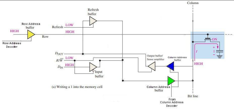

Your "fixed up" drawing can't work. A buffer like the column address buffer you have in green only flows in one direction. There is no way for the data to travel backwards through your buffer from the bit line to the sense amplifier.
You are correct. Thanks for pointing this out.

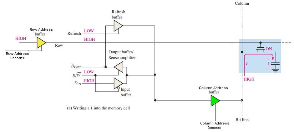

In this attachment, "sense_amplifier1", only one buffer is called a sense amplifier or output buffer but I don't think you were referring to just one buffer.
Please have a look on this attachment, "dram_cell1". In my opinion, each column line connects to column address decoder, and each column line needs to have its own input column address buffer (green), output column address buffer (blue), output buffer/sense amplifier, and refresh buffer. Perhaps, this is what you were saying. Please let me know if I have it correct.
  • Circuit schematic of a DRAM cell writing a 1: a column bit line with refresh buffer, output buffer/sense amplifier and input buffer, a row line set HIGH, and a transistor and capacitor storing a 1, with the write path highlighted.
  • Circuit schematic of writing a 1 into a DRAM memory cell, showing the row address buffer, refresh buffer, input buffer, output buffer/sense amplifier, column address buffers and the bit line with the cell capacitor and transistor highlighted.
Well, you're trying to understand the DRAM architecture at a high level, but then you're asking detailed questions like, "how come I don't have to enable the column address buffers during a refresh?" You can't have it both ways. You're never going to get the detailed understanding of how it all works that you're searching for without studying the circuits in detail. To get the understanding you want, you're going to have to go down to the transistor level. Have you tried this wiki article? It's a pretty good start. The figure "Basic structure of a DRAM cell array" shows the primary sense amplifier, which latches the data during a read. Note that because of this latching function, any time the cell is accessed, it is automatically refreshed. In fact, it must be refreshed whenever it is read, because the act of reading drains off the stored charge in the capacitor.
By the way, no, your post #12 is not correct. You won't be able to understand it at the logic gate level. You have to drill down to the transistor level. Another approach is to just accept a high level description, like: "you select a row, select a column, and the data stored in the memory cell at the intersection of the row and column gets read out". Voila! simple!

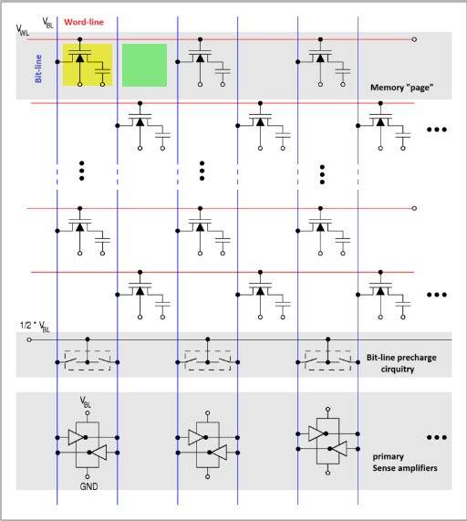

Please have a look on this attachment. The attachment is divided into three parts.
This text tries to explain it better. In Part 2 it says, "Because the cross-coupled latch is highly sensitive, it remains connected across two bitlines in order to balance the capacitive load on the two nodes of the latch and to share the sense amplifier between two columns of cells". Please have a look on this attachment showing the figure "Basic structure of a DRAM cell array" from the mentioned Wikipedia article, https://en.wikipedia.org/wiki/Dynamic_random-access_memory . You can see that on the same row transistors are connected in alternate fashion which shows how a cross-coupled latch or sense amplifier is connected across two bitlines.
Figure 8.25 from Part 2 assumes that the stored value is 1 or HIGH. First precharge is performed to Vdd/2 and voltage on both bitlines equalizes, then wordline is raised to high voltage, and data is read. We can see that as the time progresses voltage keeps rising on BL but on BL' falls toward 0 V, and the storage node voltage also rises back to its original value because wordline remains HIGH. Part 1 explains how read and write operations are performed.
I think that I was reading too much into the original text which was only trying to convey the basic operation of the circuit. But at the same time, if my attempt, "dram_cell1", is not correct, then, in my humble opinion, the author of original text is also not being precise. This is the original text. He could have done a better job with FIGURE 11-18 and in the very last two paragraphs in green at the end where he briefly mentioned the two types of refresh operations are RAS' only refresh and CAS' before RAS' refresh.

Your first attachment (with the three parts) in post # 14 is pretty good. I agree that what you called the "original text" is misleading. Sometimes the people that write these summaries don't really understand how they work. It's good that you keep questioning and keep trying to understand how these things work!
