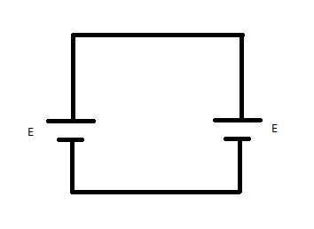

By the equation E = L dI/dt, current would approach infinity for a superconductor. If wire had resistance, the current would asymptotically approach E/R, with E being the emf. These results are what I expect, but I am having trouble understanding how current begins to flow in the first place if E = L dI/dt at all times. It seems, to me, like this circuit:
I know qualitatively that this is a different matter, but it illustrates the point that is bothering me. The two equal and opposite batteries should completely cancel one another, resulting in zero current. The differential equation (equation 2) implies that the inductor and battery act as equal and opposite sources of EMF, and yet current is increasing (and must be for the back-emf to set up in the first place).
Is it perhaps that the back-emf is only extremely close to the potential difference across the battery, but not exactly the same?
The only way dI/dt can be constant is if the current is changing. The coil can retain its back-emf only if it draws current, and that current must steadily increase with time.
A lot of feedback systems exhibit this same property, where it appears that the stasis enforced by the feedback should actually prevent the stasis from coming into being in the first place. The thing is, at the macroscopic level it appears that the potentials are precisely equal and that no charge should flow, but at the 'differential' level, there is a vanishingly small but sufficient difference to get the process started. Blame it on the finite speed of light :smile:
Once a single charge carrier crosses the line, a change in current has happened and the process has begun.
That's what I needed to hear, thank you!
