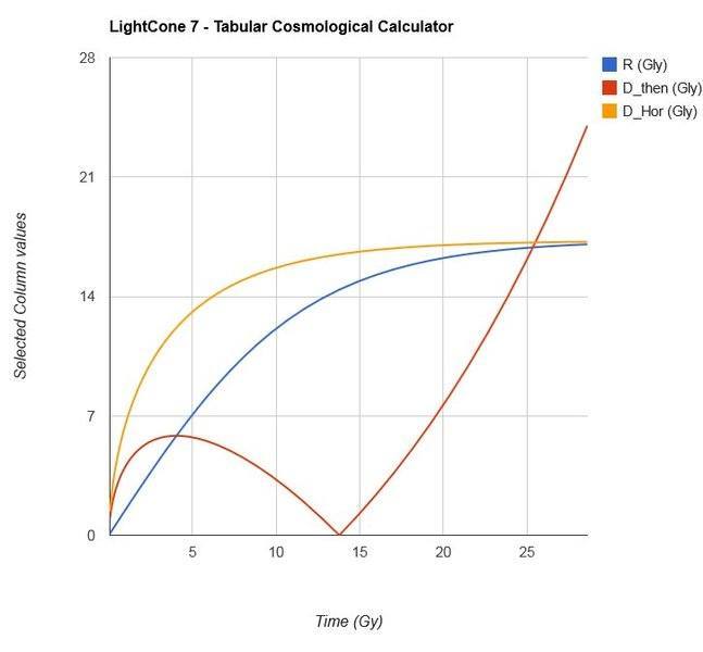

Particle Horizon Plot
Here is a plot of the cosmic event horizon (D_Hor), the Hubble radius (R) and the lightcone (D_then) for comparison.
@Naty1: You are right, it is not exactly the same, as the Hubble radius is not constant. It should be a good approximation.

The cosmic "event horizon" is NOT THE SAME as the "Hubble radius" denoted R in the table. The current size of the Hubble radius, if you look on the a=1 row, you see is 14.4 Gly. That is the distance of light which is trying to get to us but not making any progress because it is traveling thru space which is receding at exactly c. And light that is now safely WITHIN 14.4 is making progress towards us.
You can see from Mordy's table that the Hubble radius increases over time. You can also see that from the curves plotted in Jorrie's post which I just saw.
